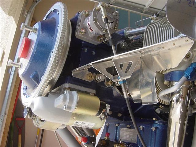

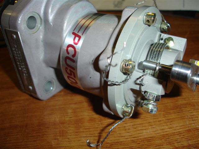

Rick,
You are correct about the gov being spring loaded to the flat pitch position. This is what I have. However, my gov is spring loaded to the flat pitch position opposite of what it should be to work on the Rv10 correctly.
Take a close look at the pictures below. Deem's plane has the correct gov. My gov is opposite of his. My gov rotates clockwise to coarse pitch. It should rotate CCW.
The arm is easy to reposition. All you do is loosen up the 6 screws and rotate it to your desired position. However, it still needs to rotate CCW to work on the RV10 correctly.
Zack

PostPosted: Tue Jul 31, 2007 7:34 am    Post subject: PCU5000X Caution Reply with quote
I missed the wide deck/narrow deck discussion but Zack's msg made me
concerned about my PCU5000. I called John at Aero Technologies for
clarification (800-323-4130). Here is what he told me.
Narrow deck engines require the .895 to 1 ratio, wide deck the .947 to 1.
The governor arm can be repositioned by loosening the 6 screws and rotating
the head but direction of rotation is done at the factory. Direction of
rotation depends on whether you attach the cable from below or above the
governor. The center shaft moves out away from the body of the PCU going to
coarse pitch.
John said if you have a PCU5000 with the incorrect ratio, one full turn on
the fine pitch stop will correct the rpm. 1 turn out will increase rpm, 1
turn in will decrease it.
So it turns out even if I have the wrong ratio, I don't need to return the
unit.
