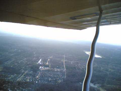

PostPosted: Fri Aug 03, 2007 10:14 am    Post subject: Wing strut vibration Reply with quote
Hello Larry,
What about this picture ? (In attach. "shrinked to 13KB ")
But i think it's more of an optical illusion than realty ...
.. but to keep this on topic, on my Twinstar MK II
the "strut shaking" definitely is related to engine harmonics
and occurs at a rather low and quite narrow band RMP ...
so it is less of a concern ...
Noel

Eugene Zimmerman
Posts: 392
PostPosted: Fri Aug 03, 2007 1:03 pm    Post subject: Wing strut vibration Reply with quote
Hey,
You really ought to remove the black snake living inside that strut
and fill it with foam.
Smile
Positively do not archive.
