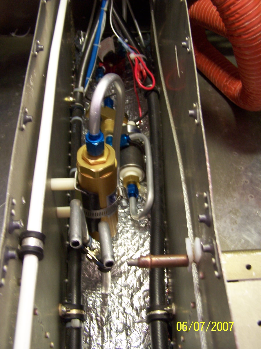

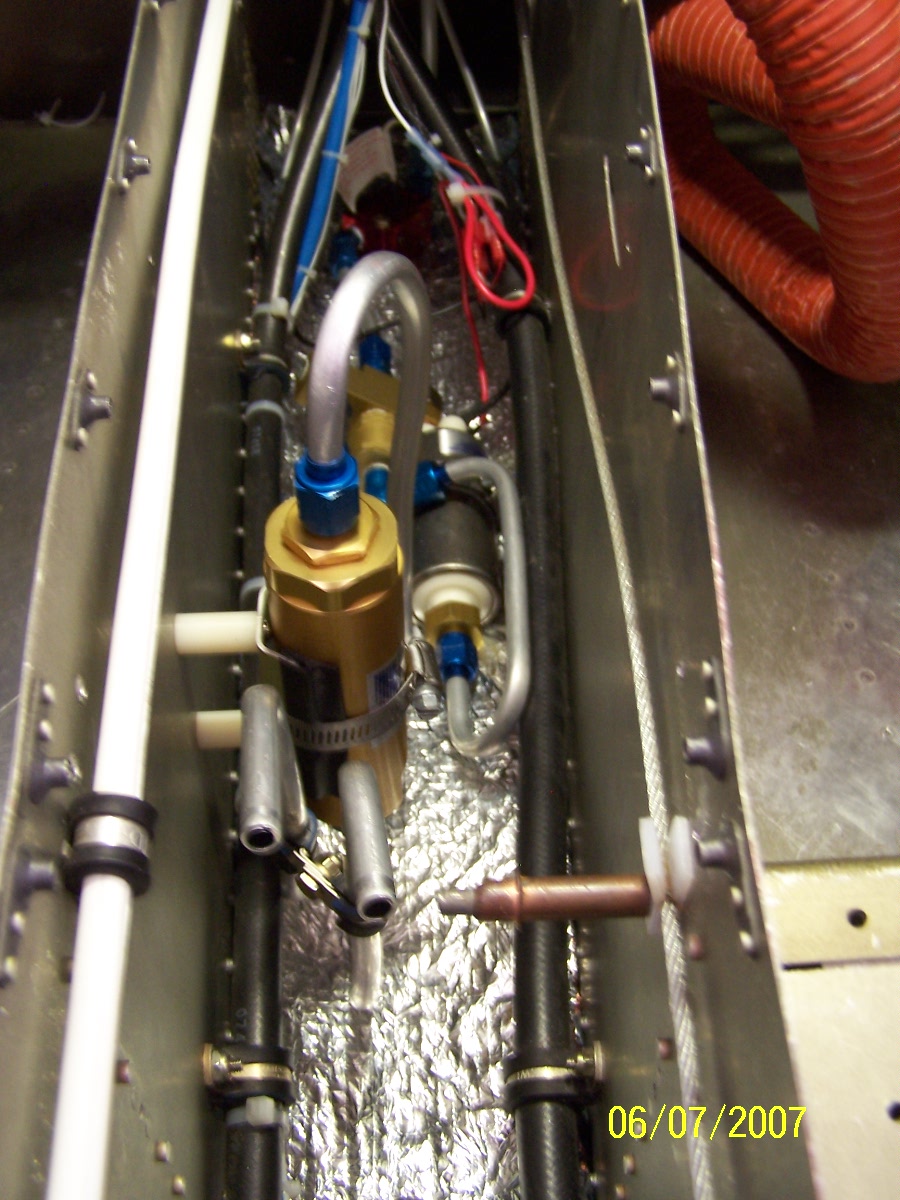

I mounted my fuel filter vertical. I used this same installation on my RV8 and it work great. The fuel filter is removed from the top. I shut off the fuel valve before removal and no spills.
Greg...
