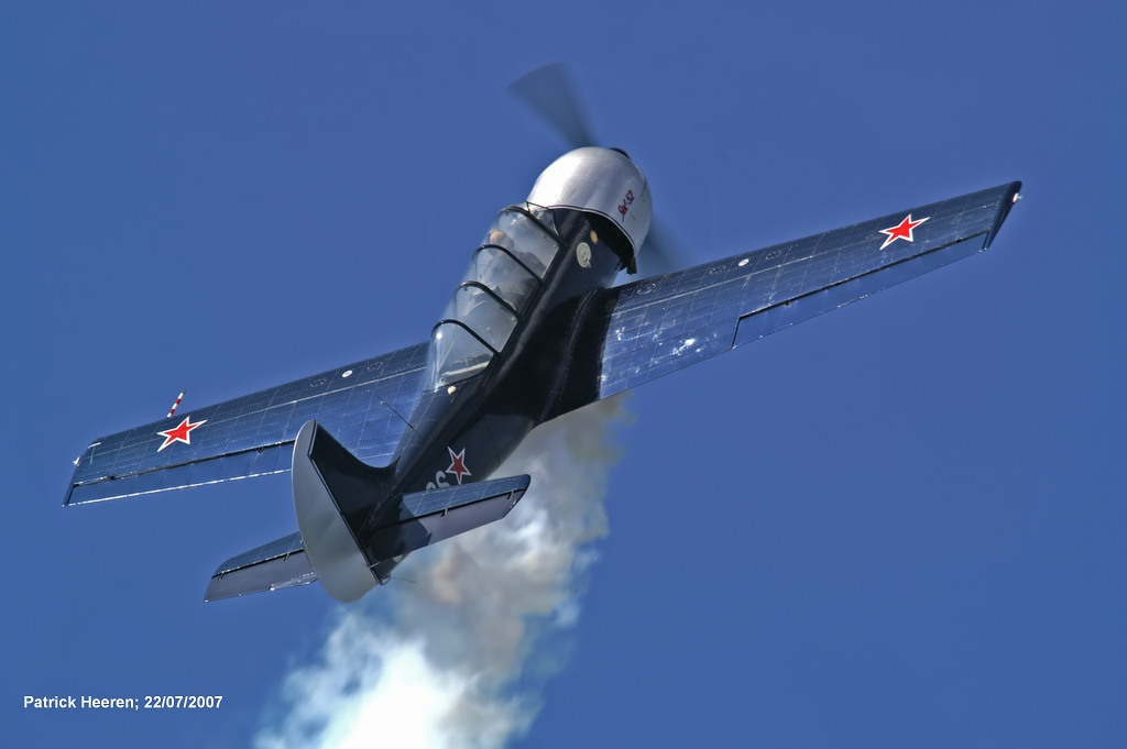

Hello Herb,
"Janie", our Yak 52 (registered G-CBSS in the UK) has smoke system.
Installed by Yak UK behind the back seat. About 20 liters.
With a reversible pump and a refill point on her belly !!
Leaks a little bit but other than that ... no problem.
And Yes, we do Flat spins and Lomcovaks ... with smoke. )
You can contact Yak UK or Termikas for more info.
See attached pictures.
