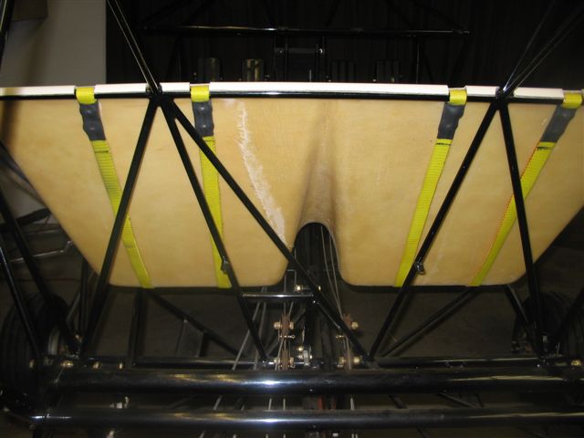

I used nylon lifting straps.
Jim Series 5 0-200 building.
Lake Elmo MN.

Very nice Jim. What are those attachments on the straps that you used?
Deke Morisse
Mikado Michigan
S5/Subaru/CAP 355+ TT
Subject: Seat Reinforcement
Lake Elmo MN.
| Back to top |
jezim(at)pro-ns.net Guest
Posted: Mon Sep 03, 2007 7:09 am Post subject: Seat Reinforcement |
3/16 pop rivets with 5/8 heads. Covered with heavy duty shrink wrap.
