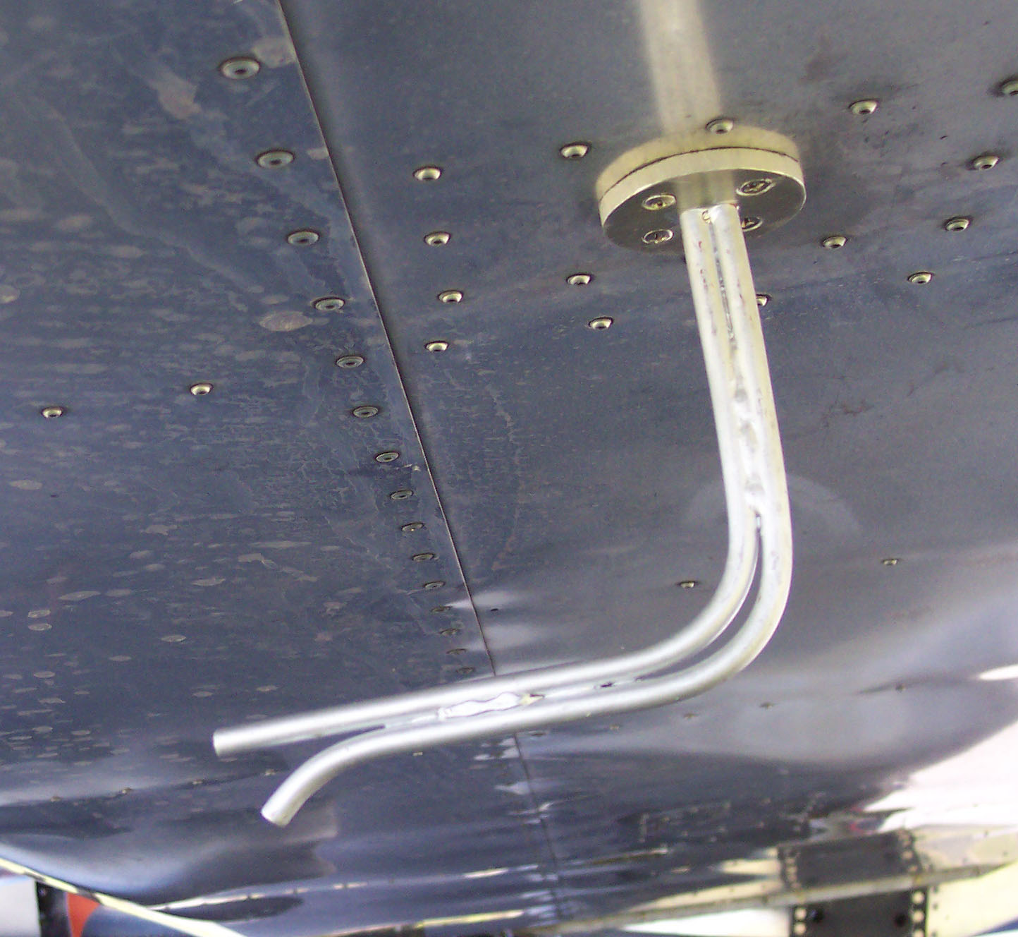

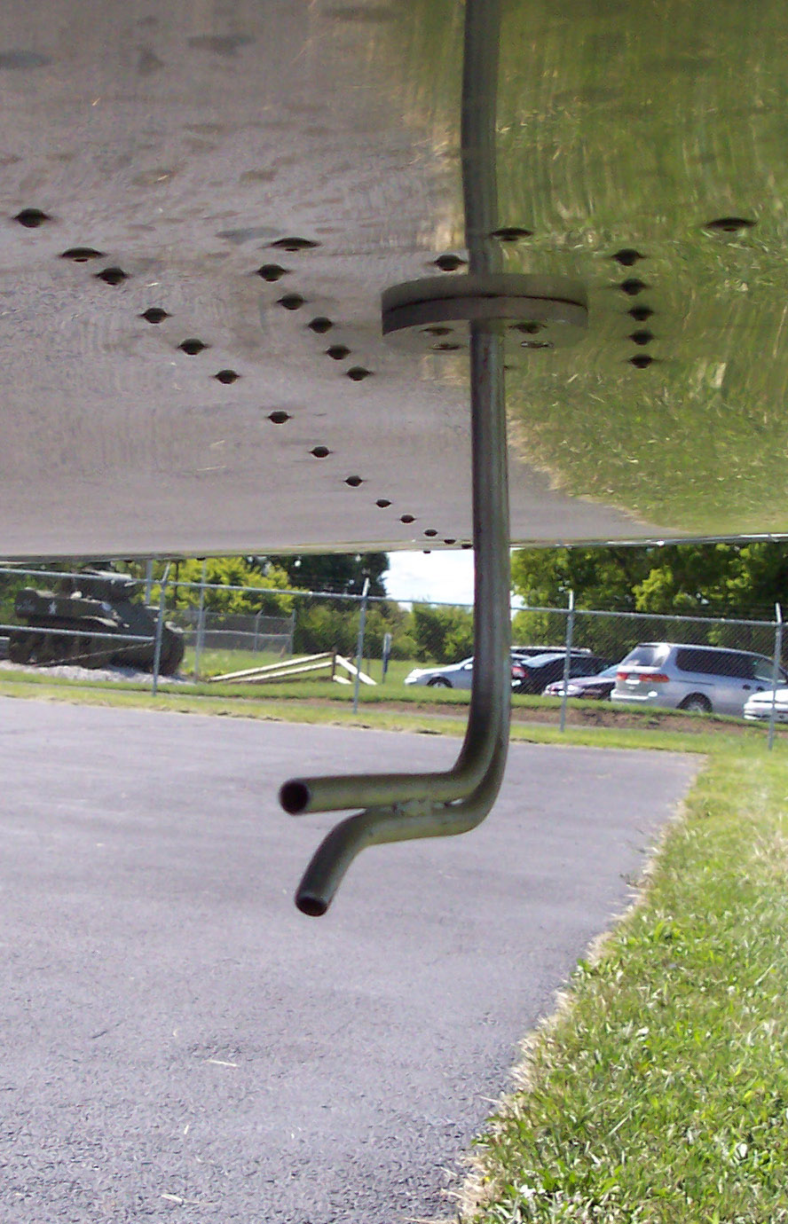

For all of you who have or are thinking of buying the Dynon and think
you would like to be able to use the angle of attack indicator it
doesn't have to cost another $200. I bought my Dynon for the attitude
display and everything else was gravy. It wasn't until after I was
flying with it I even realized that it have the AOA option. Being a
builder oh and cheap too, I though $200 was a lot to pay so I looked
into Dynon's and other AOA devices. Well anyway I made my own probe,
cost nothing time about an hour or so and I can report it works great.
Attached are a couple of pictures of the installation. The trick to ease
of fabrication is that I used copper tubing, easier to solder together.
The pitot tube is at a right angle to the support tube and the
additional tube is angled 45 degrees down. To hold it I made a slot in
the circular piece of 1/8 inch aluminum, I used my mill but it can be
done with a drill and careful file work.. Mine as a snug fit to which I
added epoxy. By the way don't start on how that copper is going to
corrode with the aluminum I keep my plane inside and dry and I haven't
seen any at other interfaces in the past year.

1. Yes I have flown with it, I did a series of stalls as indicated in
the Dynon instructions for calibrating the unit. I have also flown it
twice since and the indicator on the Dynon gives a steady reliable response.
2. It is the pitot tube. The Dynon used the pitot tube as one of the
references and the angled tube as the other. All this or any other AOA
is is a sum of the vector magnitudes of the air in each tube. It can be
shown mathematically, and I have, That with the two probes as shown
there is a linear relationship between the angle of attack and the their
pressure differential.
3. It is a duplicate of a standard probe, the only reason I used
copper is that it was easier to solder them together. You could use the
existing pitot and add the second probe you just have to fasten them
together. tie wraps?
