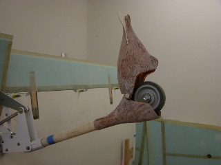

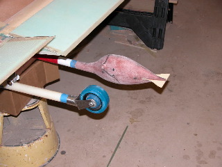

The exposed outrigger wheel is a source of drag which the speed kit
fairing doesn't address. Here are some pixs of a fully enclosed
outrigger which has a spring loaded afterbody which hinges up when
flaps are deployed; airstream on mini-tailplane locks it back down when
flaps are raised...this is a prototype not yet tested in flight...(hey,
we're building experimental aircraft, are we not?)
Fred

Hi All
We made our own speed kit consisting only of outrigger fairings and wing root fairings. While both are unlike the normal ones we felt the wing fairings made the biggest difference. We have no other speed kit elements, even the tail wheel is naked.
I designed our wing fairings based on the extensive work done in this area in WW2. This is why they are not unlike the Spitfire ones. They are also less than the optimum shape as the fuselage still has to fit in the trailer.
My monowheel G-ZTED cruises at 130 kts at 1370 pounds at 1000ft on a standard day. G-ZTED is a Classic with 912S and an Airmaster Prop. & Warp Drive blades.
William Mills and I had taken flash mouldings of my wing fairings just before his accident. While William had wanted a set for his aircraft we had intended to see if there was enough interest and arrange for someone to make more of them.
The maximum speed is more about drag and while I don’t have a 914 it is perhaps worth a mention that when I set it up for a cruise decent of 250 ft a minute, put the propeller to manual and coursen it up to produce 4800 RPM I get 155 kts which is a whisker off 180mph (test done with two opposite direction runs on the GPS). This is a reasonable test because you are beginning to hit a wall of drag. It can go a bit faster in this mode as there is a little spare boost below 4000ft but I am reluctant to fly without a margin below Vne.
I also flew with Ivan Shaw in formation. He was on our starboard wing in another Europa. When we throttled right back for the decent he commented that he was having to use a significant amount of throttle to keep up.
I know this is all not very scientific but it does appear that, with no speed kit, our fairings make us slippier than most.
I am happy to do more scientific tests if someone can say what. I am still trying to get 73 and the first stage of 74 signed off. I have done the work but the inspector is indisposed.

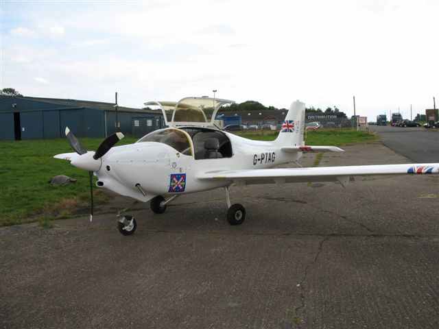

Hi! Jos
Herewith the picture of a "splash" copy of Peter Kembers Mod for the
cowl inlet ducts which Ivor Phillips kindly produced for me.
The only beef I have at present is the tendency to overheat on a delayed
departure, but many people advise this will ease by about 50 hours on
the clock.
In the short term I'm considering "jacking" the lower cowl fixings off
the fuselage by about 1" as per my previous success with the
Jabiru/Europa Cowl.
All the top cowl gills are closed and I have an insulated "bread box"
(as described by Neville!) on the P1 footwell for the Regulator unit and
the Turbo Servo unit with some cold air bled off the cooling air duct.
In flight I've never seen the temps within the box to be more than 32
deg C with ambients around 22 deg C but without the water and oil check
flaps open on shut down the temps in this box do rise to in the region
of 40 deg C.
Due to my incapability with shifting files about I'm sending on further
pictures re. this message under another separate message !
Hopefully this is constructive help in the cooling debate?
Bob Harrison G-PTAG

Thanks Bob,
Most helpful, the pictures came through good as well. The change on the bottom cowl certainly looks good. Makes me think: What about doing away with that tunnel altogether, and only have something like a boxed radiator on the bottom? It would bring back the beautiful classic look, probably reduce drag, and still having more air flowing through the radiator(s). Comments please
