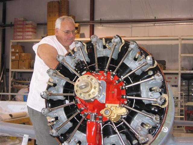

As an aside to this thread but same subject I am currently flying an M14PF (Russian Radial) that has a pressure carb and no mixture control.
