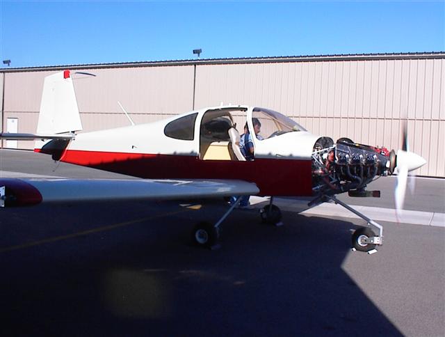

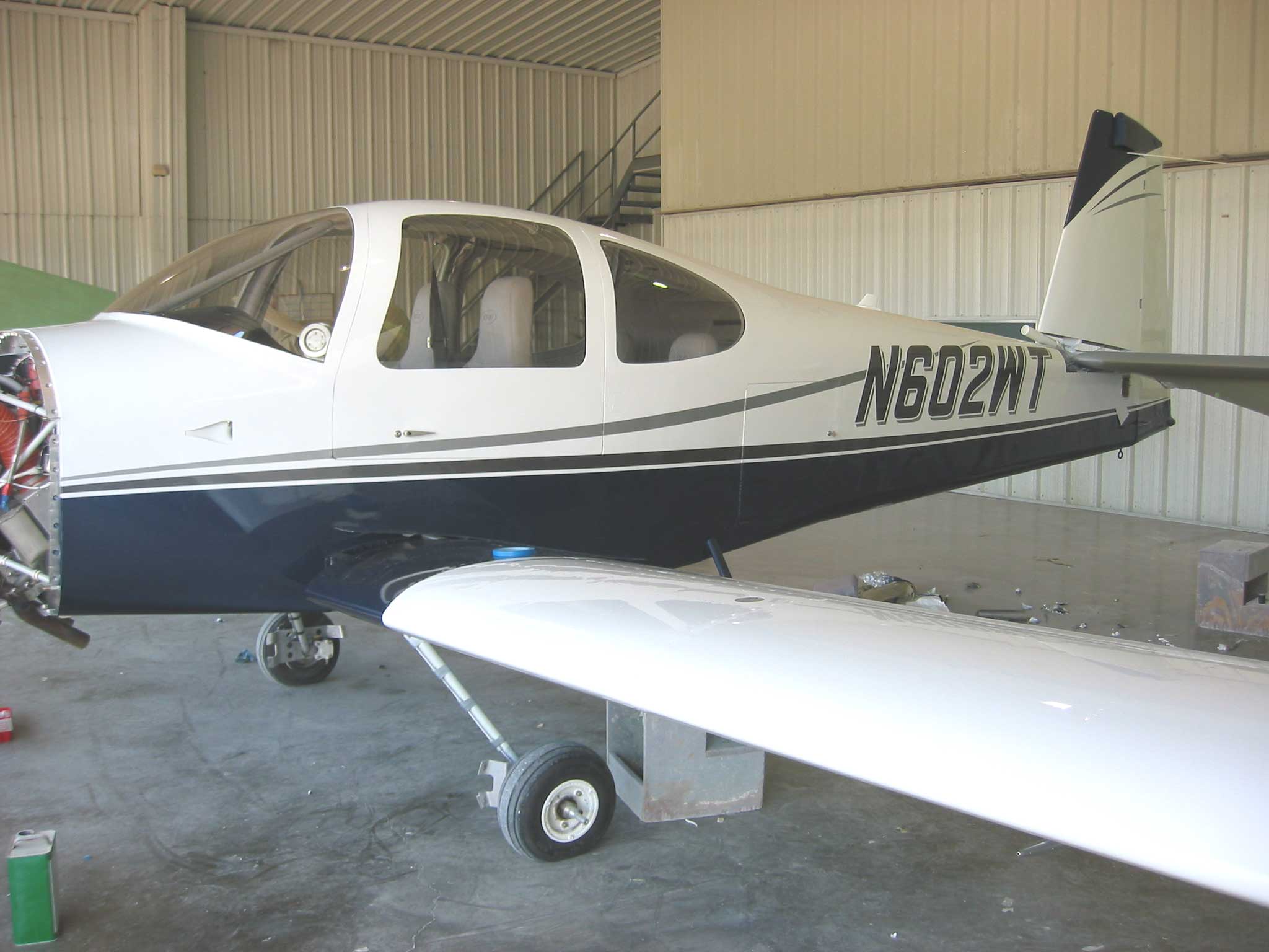

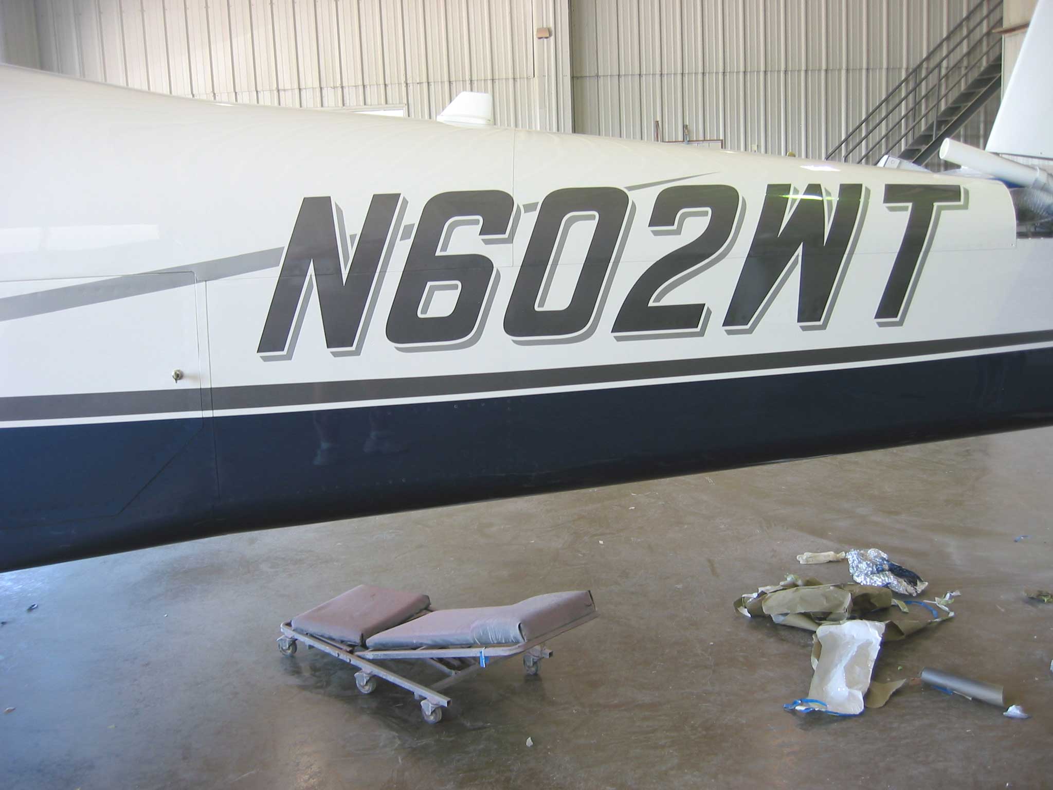

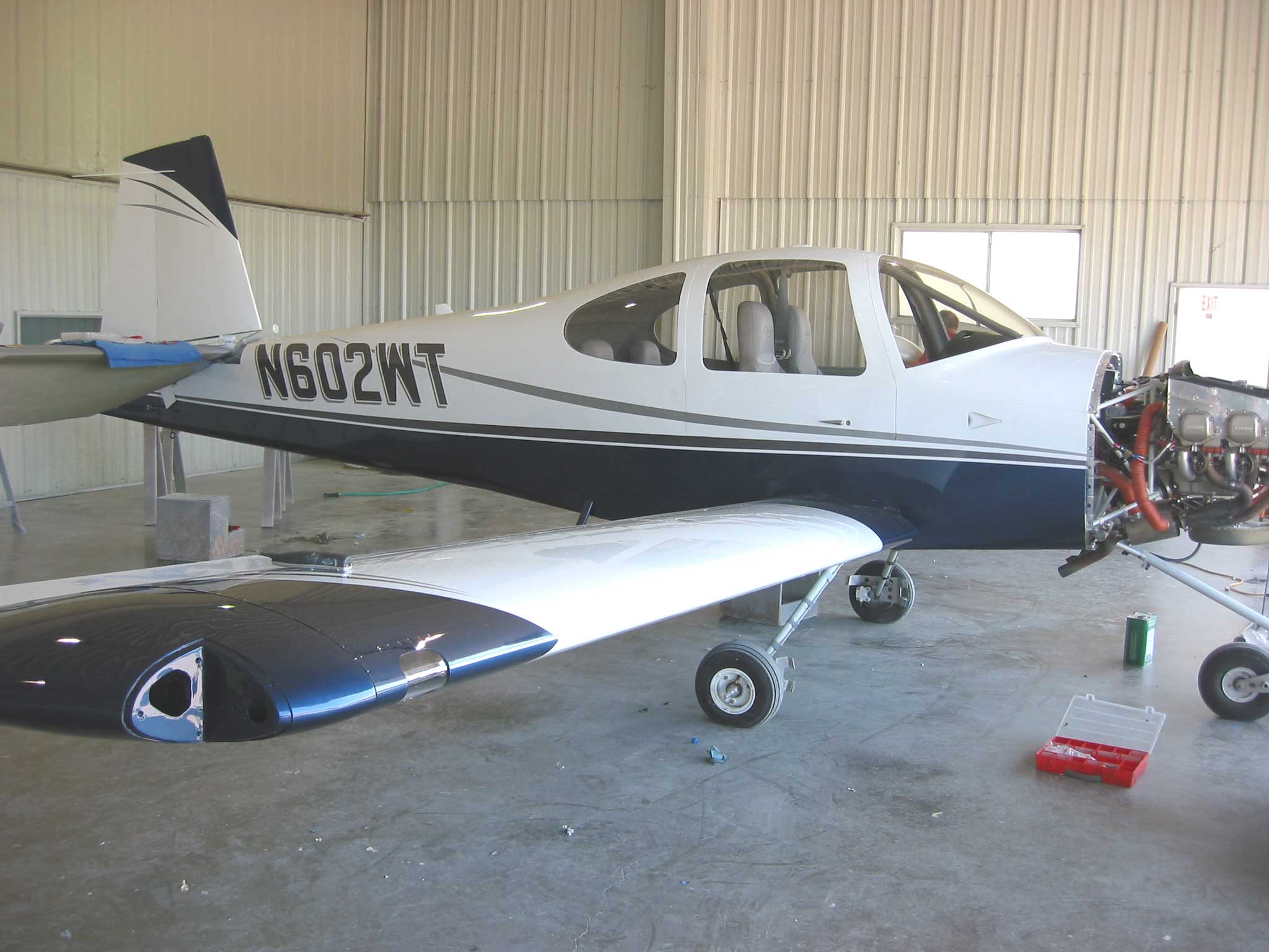

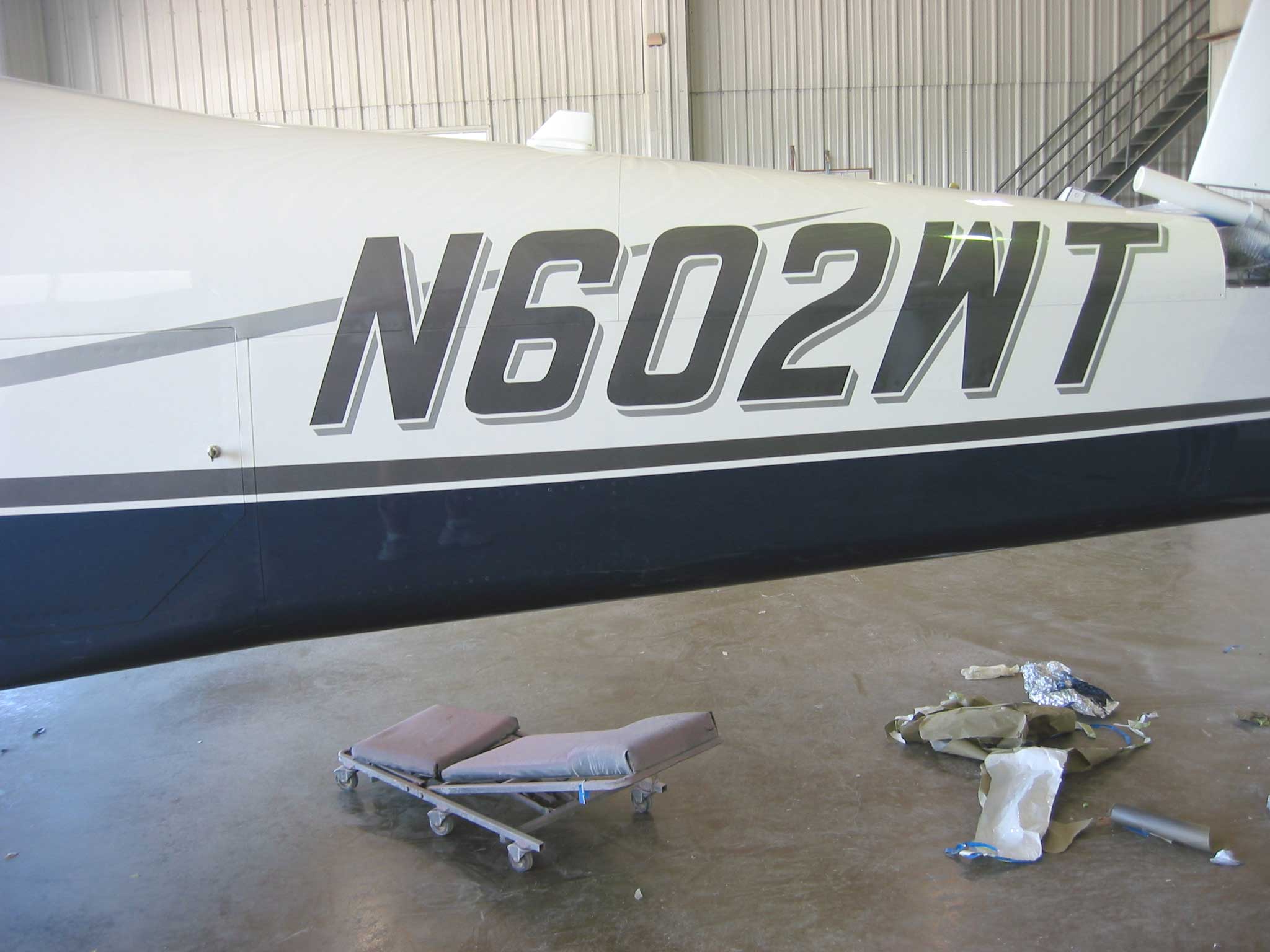

Coming out of paint shop on Manday I've attached a couple of previw pictures fo the progress thus far.

Wow, the plane looks great!!!

How has the intake on the vertical working? Tony told me about using two naca intakes and have not heard anyone speak one way or the other?
Great paint job? Been looking at that very same style since OSH.

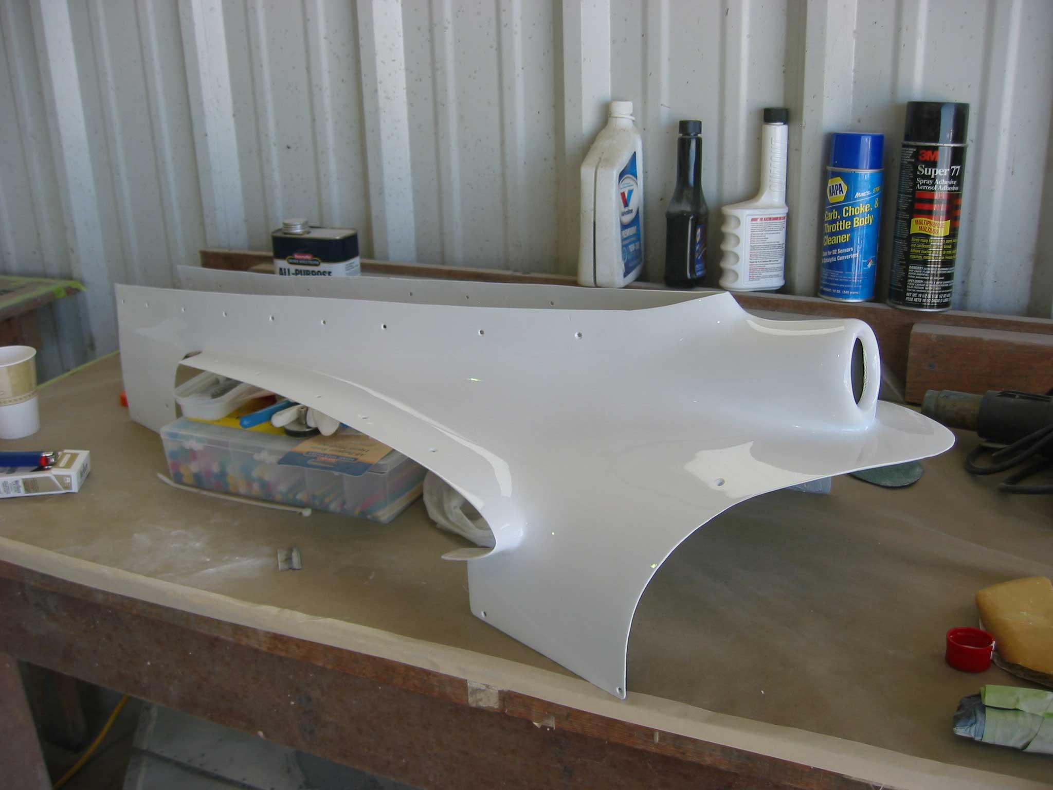

I put in NACA scoops on each side for the overhead console. Works good on
taxi but not flying yet. Plenty air.
