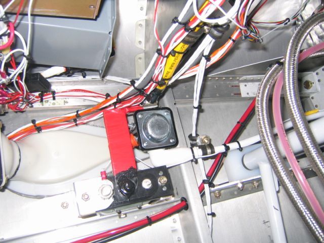

PostPosted: Tue Oct 02, 2007 9:11 am    Post subject: battery cable routing Reply with quote
Bob,
I originally intended a firewall mounted battery, so I closed up my
floorboards before I ran the cable. I wish I hadn't. The rear battery now
forces the cable up the right side to avoid going over the baggage door,
etc. That added at least 3' of cable.
Go under the floorboards and up the left side. I think there are provisions
to mount a contactor on the left side of the firewall above the oil cooler.
Plenty of room there for the cables. The starter is on the left too, so you
don't have to cross over.
I put my contactor indoors, also closer to the APU plug tie-in.
The picture is from the tunnel looking left. It would have been easy to
route the cable up the left side. Doh.

I'm curious why you would run the extra wires from the battery, Deems?
My TC aircraft has battery in same location, runs #2 to starter relay,
where lead connects to same terminal to feed the main bus, and aux bus.
The starter is only used when there should be absolute minimum draw on
the buses, and not in use when you need power for all the other stuff.
Just seems like extra wire and complexity, at first blush.
Kelly
Deems Davis wrote:
Some of it is very dependent on your electrical system architecture
and implementation.
eg.
1. Are you running a dual battery or dual alt system?
2. Where are you planning on placing the busses? If you put them on
one side or the other of the subpanel, it will likely influence which
side you run cable on.
I ran a #2 Battery to Starter contactor cable on the pilot side for
the reasons Tim noted. I also ran a #4 cable on the left side for the
main buss & a #10 for the Aux buss, as this is wher e I've located the
fuse blocks for the busses.
Deems Davis # 406
'Its all done....Its just not put together'

Kelly, the short answer is, .... I wasn't smart enough to think about
doing it that way.
Deems
