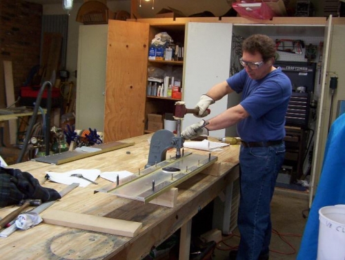

Congratulations on reaching that milestone. Here is a picture of my solid riveting machine.
