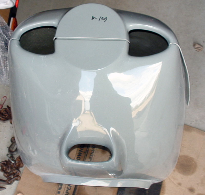

Two of the three were N601FW (Alan & Nathalie Smith) and N601WF (Stephen Smith). The reasoning is that the vents on the cowl (from Jabiru Pacific) slope back. On the side where the prop blade swings up the air bypasses the vent. So the eyebrow vent keeps the air from bypassing the vent. I don't remember what improvement was seen.

 Filesize:  34.33 KB
 Viewed:  718 Time(s)

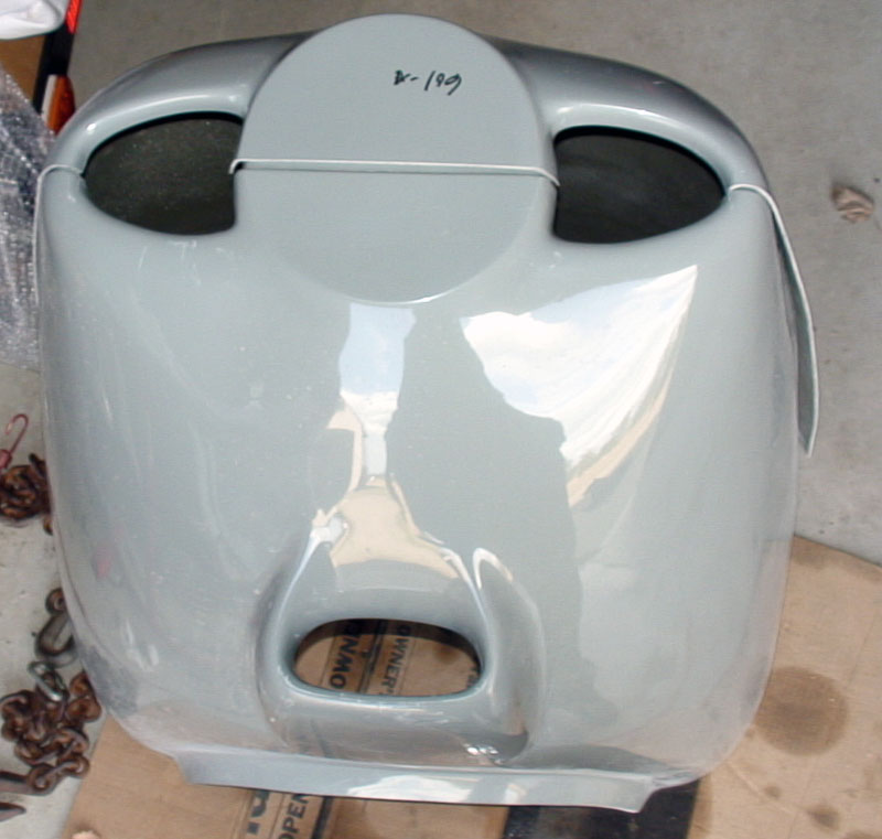

I see what you mean...... seems like there are some serious design issues with that cowling. The pix of the latest from JabiruUSA is attached. I hope it works a little better.
Tim
Newer style XL cowling from JairuUSA
 Filesize:  70.32 KB
 Viewed:  733 Time(s)
