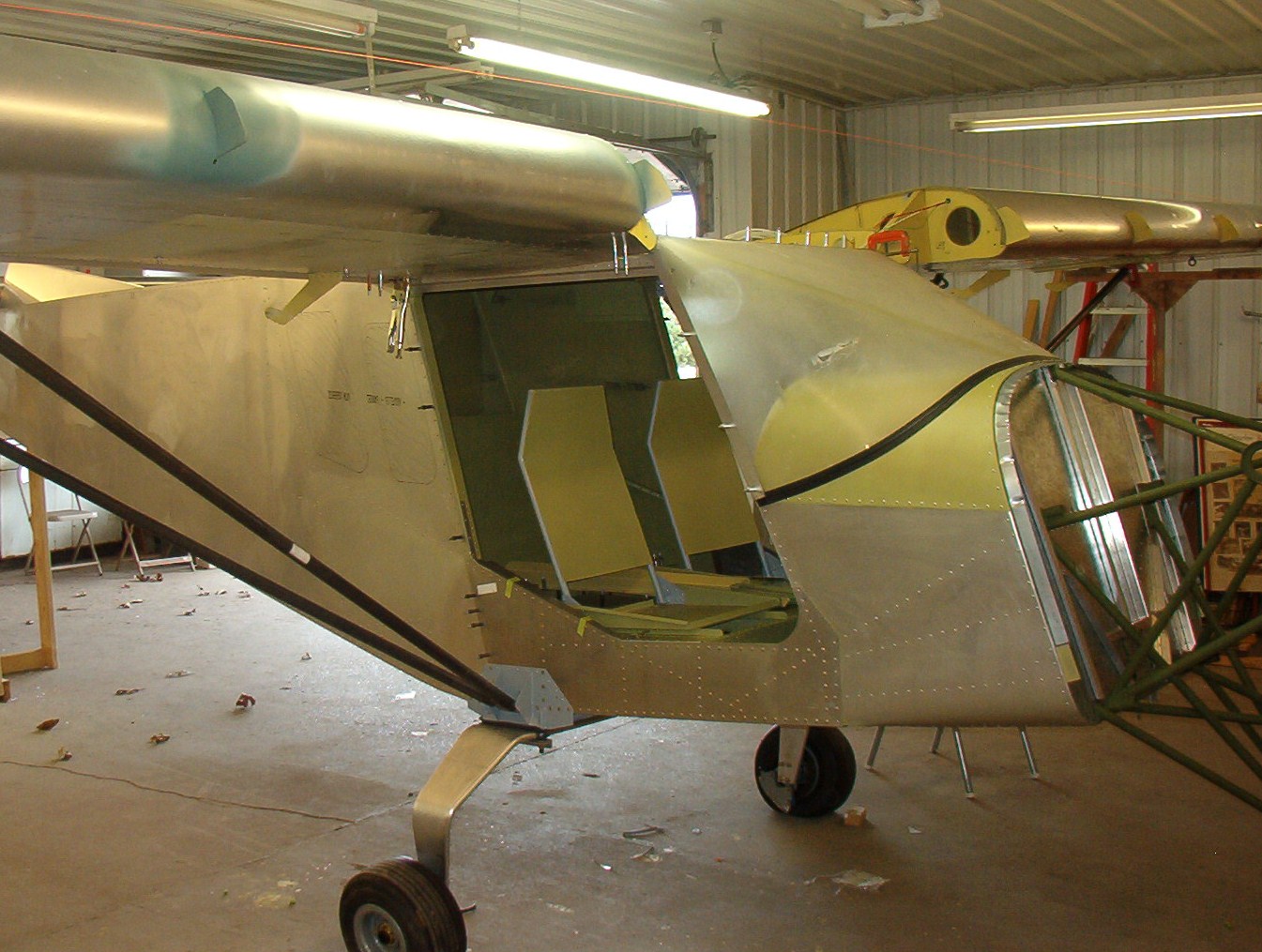

can anyone tell me if the total flaperon defection on an 801 is 30 degress with full flaperon defection or 30 degress plus the 13 degress of flaperon defaction,and has anyone had to adjust their electic flap motor stops or just used the factory settings?
the flaperon bellcracks rubs the floor skin with that much movement

My 801 did the same thing when adjusted to the full flap setting. I set mine so just as the bellcrank get close to the lower fuselage skin the microswitch stops the flap motor. Trust me, you won' want to get to full flaps.
