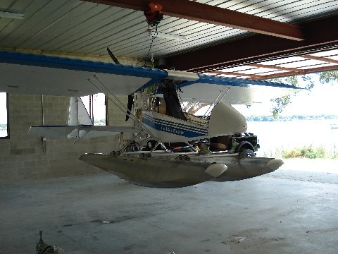

PostPosted: Sat Nov 03, 2007 4:34 am    Post subject: I am getting a Kolb MK III!! Reply with quote
Look Ma, No Hands
Steve B
Firefly 007/Floats
 Filesize:  42.49 KB
 Viewed:  422 Time(s)
