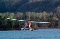

If my plane were kept in a hangar rather than the garage and I didn't have to defuel my wings and tie down the floats for transport I expect I could get the wings unfurled and all ready fly launch within the fifteen minute mark.
From the time I leave the house with the plane in tow I count on close to an hour and a half to be in the air.
Recovering the plane to the trailer, de-fuelling, folding the wings, tying down and towing home is about another hour plus. I also like to do a post flight inspection. That takes another ten minutes.
All totalled when I go flying I will spend close to four hours not including the duration of the flight itself. No wonder I hardly ever go for less than two or three hours of flight.
BTW the pond is about 15 min from the house towing at a ripping 20 km/hr.
