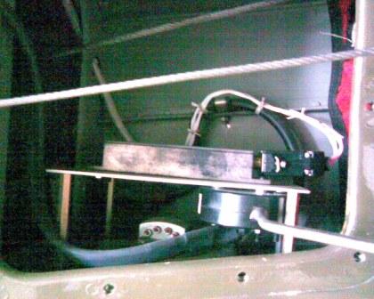

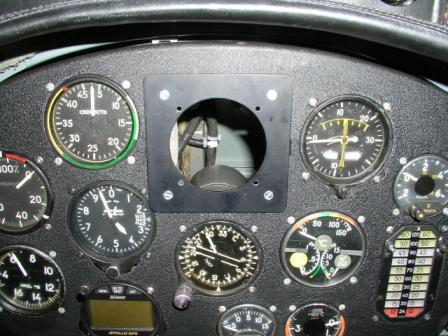

Here are a couple of pictures. You'll notice the magnetometer mounting bracket also has a VOR antenna mounted to the bottom of it. The set up makes for a very crowded tail but has worked well thus far. Excuse the shameless plug but I offer a couple of the parts as kits on my website. Feel free to give it a look at
www.thedefiantcompany.com.
Scott

I was looking at the EFIS Sport and based in the website information it
looked to me like if you removed the RMI and the ADI the EFIS would fit in
the hole for the RMI. I never had a chance to test that theory though.
S

Pull the ADI out and it fits perfect. Will have to make a back plate to bolt
it to your panel though. Postive side is you lose the inverter!
Doc

Hello Scott,
I have been looking at your pics with interest as I have been thinking about the BM Lite in a 52. A couple semi-related questions... Are those annunciator lights stock (the ones outside the G-meter/annunciator/compass pack)? Also, how did you manage to get an XPND between the intercom panel and the primer???
VR,

LawnDart,
The annunciator lights are stock as far as I know. My 52 was produced in
1982 (hence the tail number N8252) so it is an earlier model. I've seen a
picture of one other early model with this configuration so I'm guessing it
was changed in later production lots. I have never been able to confirm
that. Anyone else know about this?
The xponder was installed prior to my purchase of the airplane. As I
understand it my primer is reversed for a '52 and was taken from a '50.
Cylinder prime is to the left and fuel system is right. I think it is also
located higher on the panel than a stock '52. Again Having never flown
another '52 or a '50 I don't know what's normal for either one. This is
another question for the group. But I do know that the change was made
specifically to accommodate the xponder.
Scott

Thanks Scott.
I have seen the older annunciators panels with the lights similar to the gear indicators however never seen one like yours - interesting.
Also your G-meter goes to 10+, different than the ones I have flown as well.

1982/83 saw a change in the annunciator panel of the Yak-52 (as well as
many other changes).
A transponder will fit where the old radio head was installed, but
typically, this blocks access to anything through the kick panel on the
side.
