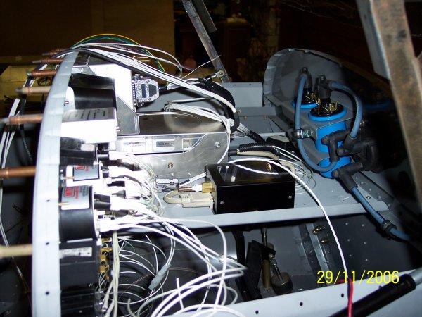

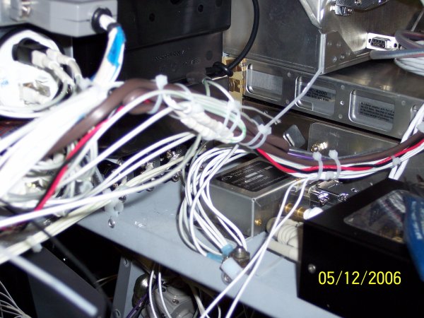

PostPosted: Thu Nov 08, 2007 5:54 pm    Post subject: Dynon remote compass location Reply with quote

PostPosted: Thu Nov 08, 2007 8:45 pm    Post subject: Dynon remote compass location Reply with quote
That looks like a very problematic location for the remote magnetometer. Looks like there are a lot of high current and magnetic field producing stuff in the immediate area. Am I missing something in these photos?
Mine is in the tail behind the aft bulkhead of the baggage area.
Dred
Afterfxllc(at)aol.com
PostPosted: Fri Nov 09, 2007 12:13 am    Post subject: Dynon remote compass location Reply with quote
Over 100 hours no problems
PostPosted: Fri Nov 09, 2007 1:44 am    Post subject: Dynon remote compass location Reply with quote
We first thought it might be a problem and were prepared to move it but it tracks dead on with the vertical card frankly I was more worried about radio interference but everything works great. I like this setup because everything is so compact.

dredmoody(at)cox.net
PostPosted: Sat Nov 10, 2007 8:43 pm    Post subject: Dynon remote compass location Reply with quote
That sounds great. i would have been way too chicken to install it there. I'm taking for granted that the remote magnetometer and the vertical card compass are not simply duplicating each other's errors since they are situated very close to each other. You have probably checked their readings on a compass rose with everything turned on and running, right?
Ed
