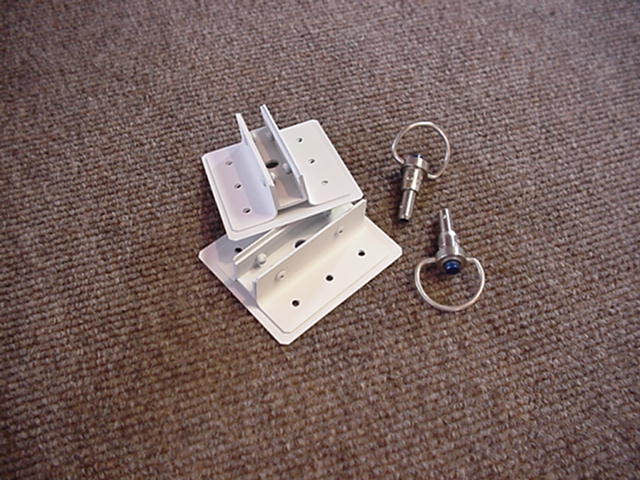

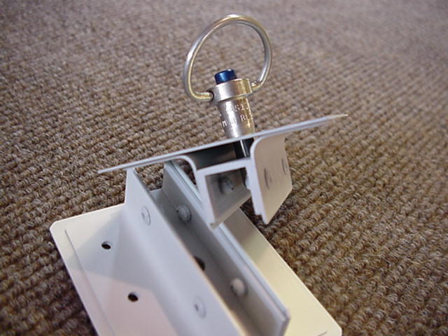

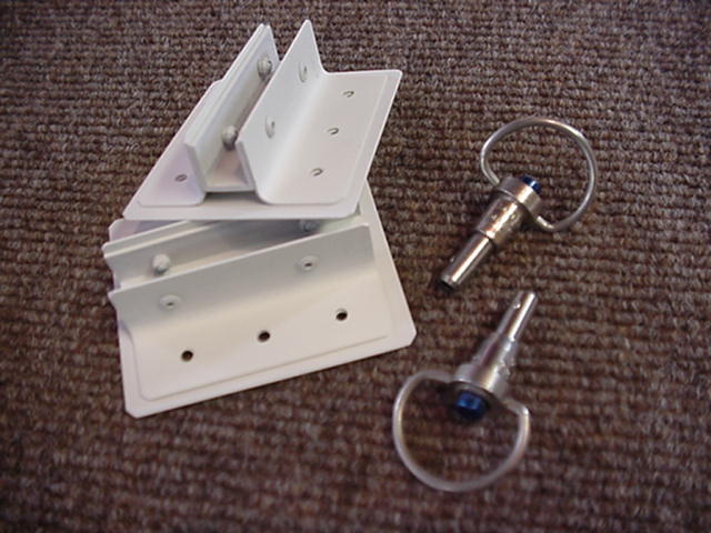

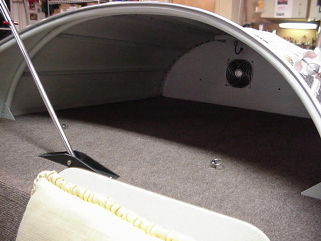

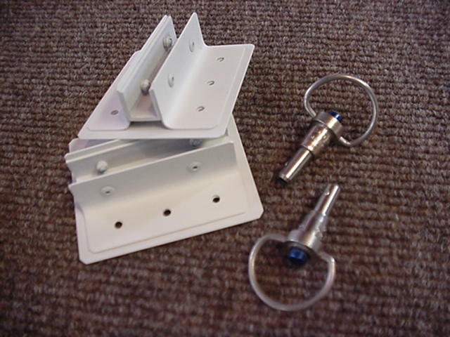

This certainly doesn't address all your questions but here are some forward tiedowns I made on-the-cheap from rings purchased in the Osh flymart. In the rear of the compartment I have the Van's tiedowns. Both are removable but the forward ones leave a flat floor.
http://www.vansaircraft.com/cgi-bin/catalog.cgi?ident=1195078564-350-492&browse=airframe&product=tie-down
tailwinds jeff
