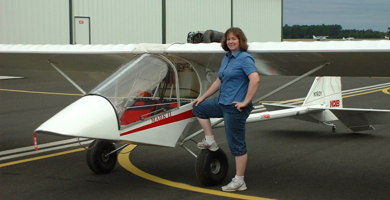

Posted: Thu Nov 22, 2007 3:43 pm Post subject: Re: Mark II is an airworthy ELSA |
Thanks. My operating limitations say I could fly off the 5 hours as a student pilot IF (the big if) I was signed off in a Mark II.
I've attached one picture. I need some nose art. See my big tundra tires? What psi would you recommend? The max psi on the tire says 20. The DAR said some guys only put like 3psi. I'm not on a grass field.

Posted: Thu Nov 22, 2007 4:10 pm Post subject: Mark II is an airworthy ELSA |
Quote: | I've attached one picture. I need some nose art. See my big tundra
Cristal,
I have 800 size tires on my Firestar. I first had 6 lbs air in them and
ended up spinning the tube in one tearing off the stem. I am now running 10
to 12 lbs and they do well and are not too bouncy. If you don't do tubes,
perhaps you can use less air, but I haven't noticed any ill effects on my
landings from the amount of inflation that I now have.

Posted: Fri Nov 23, 2007 5:02 am Post subject: Mark II is an airworthy ELSA |
I never use a gauge (on an airplane) inflate until it feels
unyielding to the heel of your hand
when pushed hard. Works ok on these cheap flimsy tires, maybe not so
good on those
heavy multi-ply (expensive and unnecessary ) real airplane tires.

Posted: Fri Nov 23, 2007 6:18 am Post subject: Mark II is an airworthy ELSA |
At 08:01 AM 11/23/2007, robert bean wrote:
Quote: | I never use a gauge (on an airplane) inflate until it feels
unyielding to the heel of your hand...
When I was into offroading we had to run pretty low pressures in oversized
tires, I think I ran 3 psi offroad and 12 psi on the street. The typical
tire gauge is very inaccurate at those low pressures, I made my own with a
15psi industrial pressure gauge and a tire chuck. Offroad pressure was as
low as you could go without the tire coming off the rim, for the street you
still couldn't use the OEM pressures so you'd see how evenly a chalk mark
on the tire would wear off.
I go by feel, then use the low pressure gauge to verify they're equal.

Posted: Sun Nov 25, 2007 4:43 am Post subject: Re: Mark II is an airworthy ELSA |
Hey Guys,
In the picture of Crystal's Plane....
Look at the "trim tab"....is that "size" really needed ?
Seems too big , almost like it could cause "Flutter"
it's almost touching the ground , I'll bet it has.
Gotta Fly...
Mike & "Jaz" in MN FSII/ No trim tabs

Posted: Sun Nov 25, 2007 6:08 am Post subject: Re: Mark II is an airworthy ELSA |
My trim tab does drag ground if I don't keep my stick pulled back. I keep a bungee cord on it when I'm not in it.
I don't know if it's my trim tab that is too big. When I look at the picture of ropermike's Mark II, his trim tab looks to be about the same size.
However it looks like his tailwheel keeps the back of the plane up higher than mine. Kmet suggested (thanks Jim) I turn the tailwheel landing gear rod around back there to make it higher, but I'm not sure exactly what part he's talking about (the whole rod or just the attachment at the end). Let me get a close up picture of my tailwheel assembly and post it here. I'll try to get it this afternoon. I'm having to replace the nut back there with a castellated nut (per the DAR) so I have it apart right now anyways.

Posted: Sun Nov 25, 2007 8:11 am Post subject: Re: Mark II is an airworthy ELSA |
Hi Crystal,
I'm sure he's talking about turning the rod over...
it might be a little "sprung" , you can use that to your advantage by
giving it a 180....
You can't always Taxi with the stick "back" ( some do )
Sometimes it's confusing , which way to hold the stick ( Not anymore )
One of the best "sayings" that I heard when I was getting my Tailwheel
endorsement was this....
"Wind Behind" - Blows the stick
"Headwind" - Pull Back , stick into the wind
That "saying" helps me "Just do it" , instead of thinking about it...
You've got a nice looking plane !
