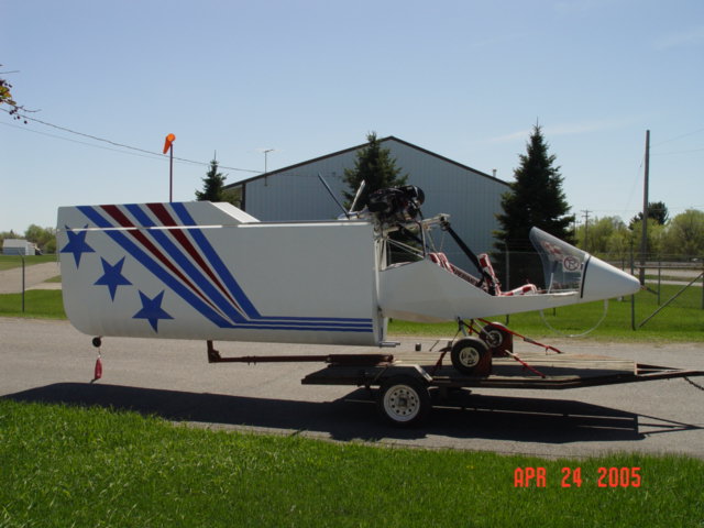

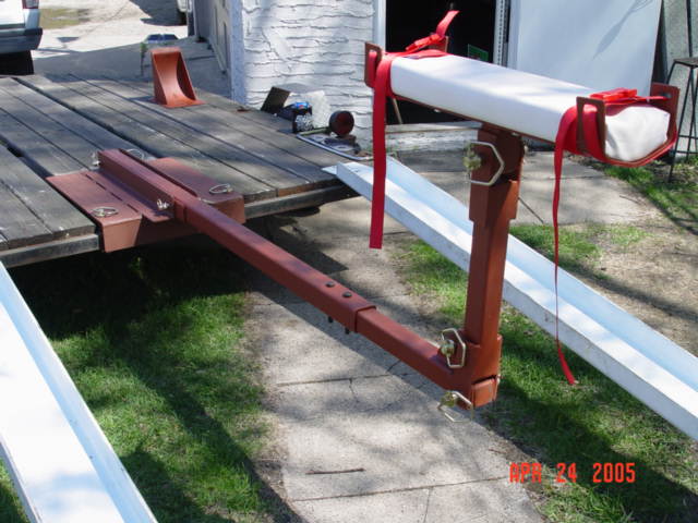

| grantr wrote: | | Are there any plans for a simple boom stand? |
I don't know about plans, but I may try to copy this guy's boom stand (picture attached). But looks like it's just for storing, not traveling.

Here's a picture of the telescoping stand in my trailer:
http://img.photobucket.com/albums/v486/flyparafan/Kolb/Trailer_1193.jpg
You can't see too much, but I can take some more pictures if anybody
wants. Basically it swings up into position and straps to the boom, then I
simply lift the boom and it extends and locks into place.
-Dana

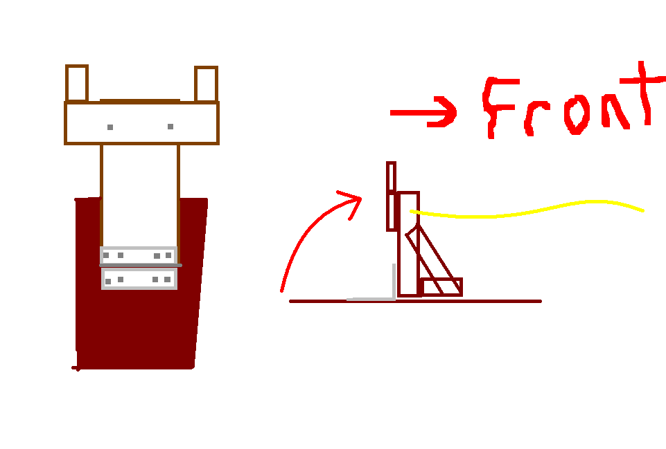

I am thinking of using a 2X6 and some heavy duty hinges to make a swing up boom stand.
I attached a sketch . the gray is the hinge. yellow is the rope.
front being from of the trailer.
What do you guys think of this?

The cradle itself is a piece of PVC pipe, split down the middle, and lined
with closed cell polyethylene foam, with wood support. The cradle pivots
at the end of a 2X4 which telescopes into the main support. In the "up"
position, it's supported by a spring loaded latch (made from a plastic
block and a spring load door hinge). A ball lock pin backs it up when it's
on the road.
The main cradle is two sections of plywood sandwiching the inner 2X4's,
forming a pocket for the moving piece to slide into (the moving piece is
shaved down slightly so it moves easily). The whole arrangement is hinged
to the floor of the trailer, so it can fold down and allow the plane to
roll out.
The latch makes it easy: I roll the plane into the trailer and strap down
the main wheels. Then I flip up the support, extend the cradle, and strap
it to the boom tube. I then simply lift the tail up until the latch clicks
into place, put the safety pin in, and I'm ready to go.
The pictures show the sequence in reverse. The safety pin lanyard is
attached to the latch, so that's what I pull to release the latch, while
supporting the tail with my other hand, which I then lower gently to the floor.
The only change I intend to make is to add a cable to limit how far back
the support can pivot, so that if the wheel straps come loose, the plane
can't roll back against the doors.
-Dana
