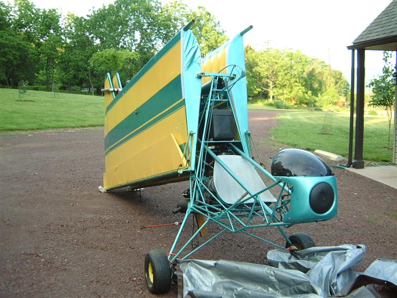

Posted: Thu Nov 29, 2007 9:33 pm Post subject: Re: Ultrastar fuel tanks |
Here are some pics of my fiberglass tank.
| Description: |
| Filesize: |
232.23 KB |
| Viewed: |
483 Time(s) |
| Description: |
| Filesize: |
1.24 MB |
| Viewed: |
483 Time(s) |

d-m-hague(at)comcast.net Guest
Posted: Fri Nov 30, 2007 3:56 am Post subject: Ultrastar fuel tanks |
At 12:33 AM 11/30/2007, jb92563 wrote:
| Quote: |
Thanks Ray,
That does look like it was nicely done. How does it attach to the
frame? If I change the tank or add an aux tank I'd rather not do any
welding on the frame.
Always interesting to see the differences... sometimes I think I'm the only
one without a nose fairing! Though yours is the only one I've seen besides
mine with the wing leading edge tubes extended outside of the center rib...
I have a tube that sleeves over them, that gets slipped into place joining
them together after the wings are unfolded. What are those rectangular
projections that look like "handles" on the main downtubes, just behind and
above the seat? Also, no fuel pump? And is that a crack in the engine
frame, just above the left rear mounting bolt, or just dirt?
-Dana

Posted: Fri Nov 30, 2007 7:19 am Post subject: Re: Ultrastar fuel tanks |
Those pictures are of the plane as I received it.....dirty.....but no cracks.
Those things that look like handles are handles.
I hang on to it, plus put my foot in front of the wheel when pull starting so I don't end up in the prop if the Kolb start rolling.
The glass tank inserts from the seat area(remove seat) and has molded in saddles on the bottom and top so it can ride on the frame cross members and is attached with hose clamps.
It is offset to the left side well clear of the control rods on the right side of the frame.
I also think its more than 5 gallons......perhaps 6.
I installed a different fuel filter....sump type and also put a pump on the engine bracket where you see those 2 holes.
Also missing from that pic is the short whindshield, my instruments and the 4" drum brakes I just got that I need to install.
I also need to zinc chromate a bunch of parts and do some painting.
But the poly fiber is all patched and ready to go.
_________________ Ray
Moni MotorGlider
Schreder HP-11 Glider
Grob 109 Motorglider
Do Not Archive |

If the attachment comes through you can see how the Exmark Turf Tracer 5 gal. tank fits nicely in gravity-feed position.
Dave Kulp
FireFly 098

undoctor(at)ptd.net Guest
Posted: Sun Dec 02, 2007 9:47 am Post subject: Ultrastar fuel tanks |
Hi Dana,
I did a reply to the list with an attachment showing the Exmark fuel tank in my Ultrastar. Hope it helps. If it doesn't come through and you'd like to see it just email me and I'll send it off line.
I got a kick out of your response to the wisea$$ about "just fly it." Got curious as to what you actually do and found your info on Google. It may interest you to know that my bro is the same. If you go to the REM site at http://www.remassociates.com/ , expand the consultants tab in the nav column and click on Linwood Kulp, you can read about him. Maybe your paths have crossed.
Dave Kulp
