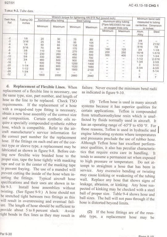

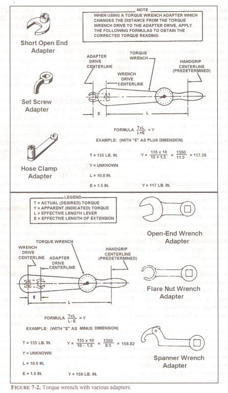

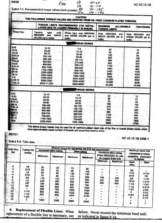

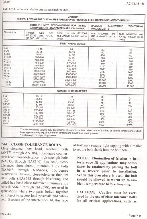

Bill, maybe these will help. Note pipe and AN values.
Bill S
7a Ark
