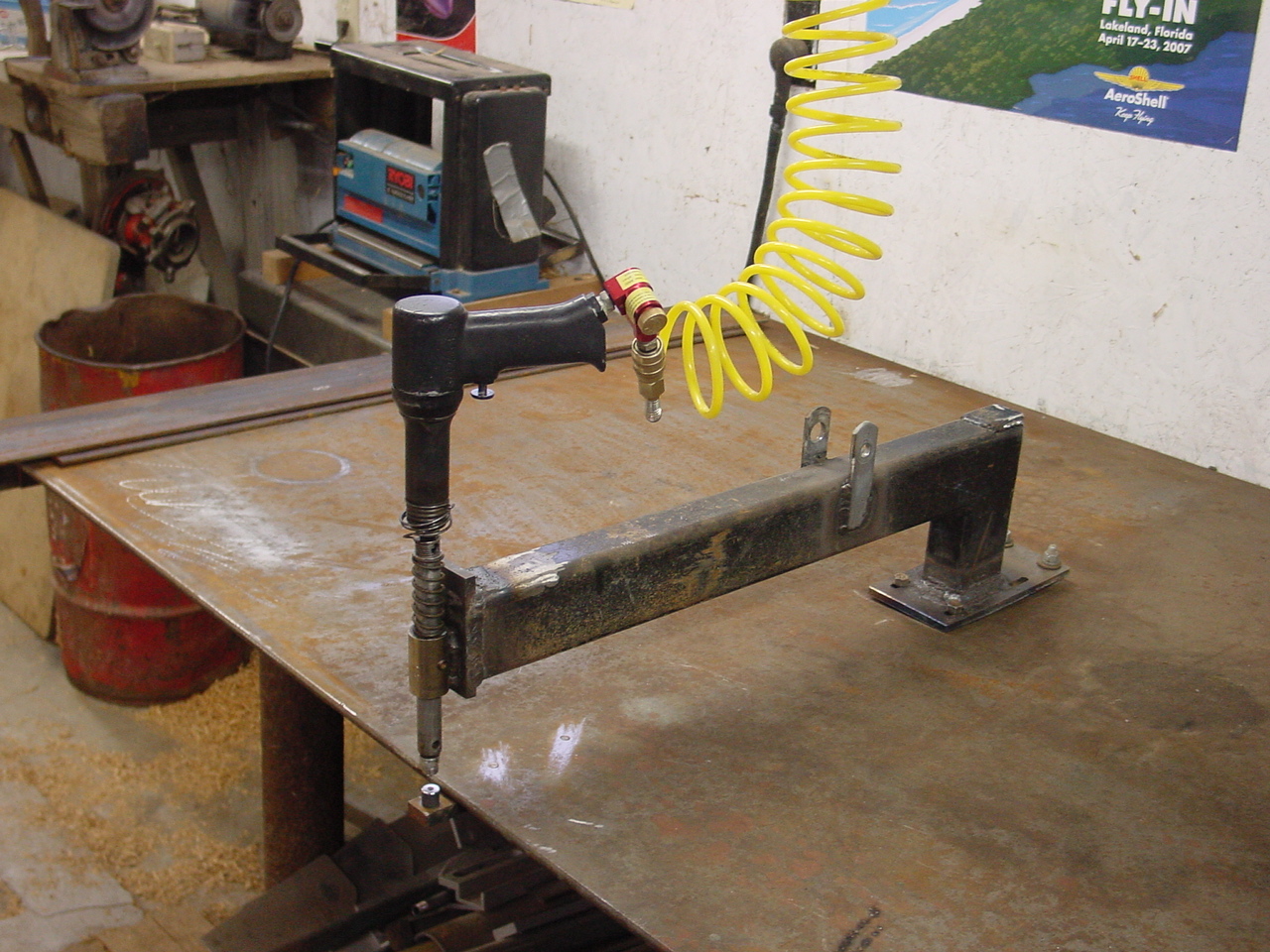

I also built a c-frame dimpler from some scrap I had laying around the shop. I mounted my rivet gun to the top of the piston for a very efficient way of dimpling skins. It really works quite well. See attachment.

Very interesting set up you have for your C frame.
How do you get your rivet gun to convert from an automatic to a single fire?
It looks like you have your dies in upside down, with them that way, you will be missing a lot of holes and making some unwanted ones. I think it would be helpful to also make your table extended out beyond where the dies are to help support the material. Don't forget to put down the carpet on the table.

I just tap the trigger which gives about 2 hits and works well.
I must have put the dies in upside down for the picture. Or maybe I should check to see if the dimples on my parts are all innies!
I put the dies out to the edge to facilitate getting the prebent (HS) skins under the table when dimpling the opposite side.
And yes I do have all surfaces covered to keep from scratching things.
