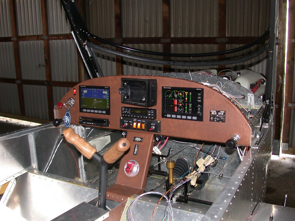

Attached is a picture that shows the aluminum fuel line going from the Andair selector valve running to the firewall and down to a AN bulkhead fitting on the lower right. The Gascolator is on the other side of the bulkhead fitting. The standard ZAC quarter inch inside diameter synthetic rubber fuel lines come from each leading edge fuel tank through a filter and Facet pump next to the tanks to the selector valve. Fuel pressure sensor, 3300 mechanical pump, and final filter are in front of the firewall.
Jeff
