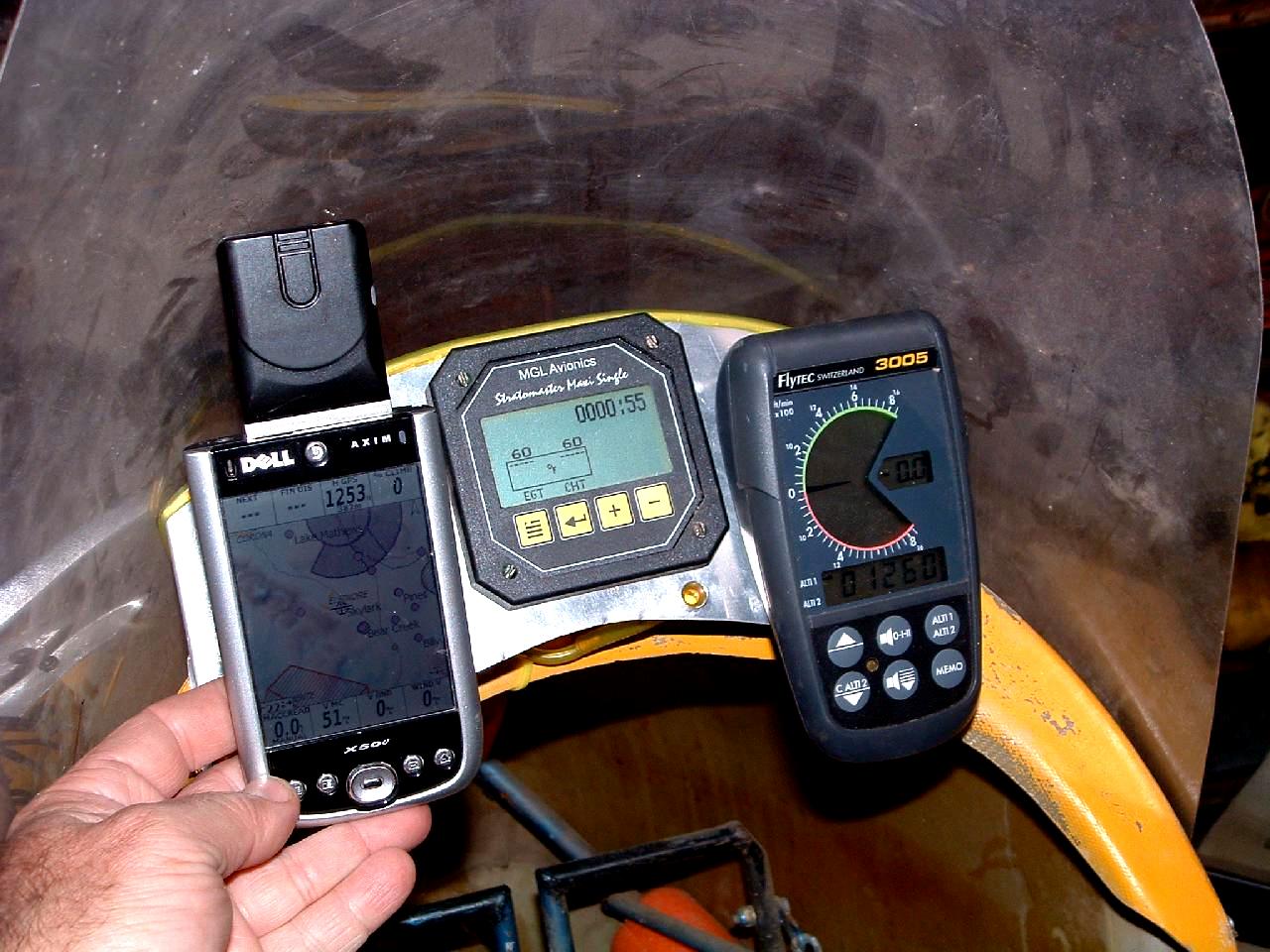

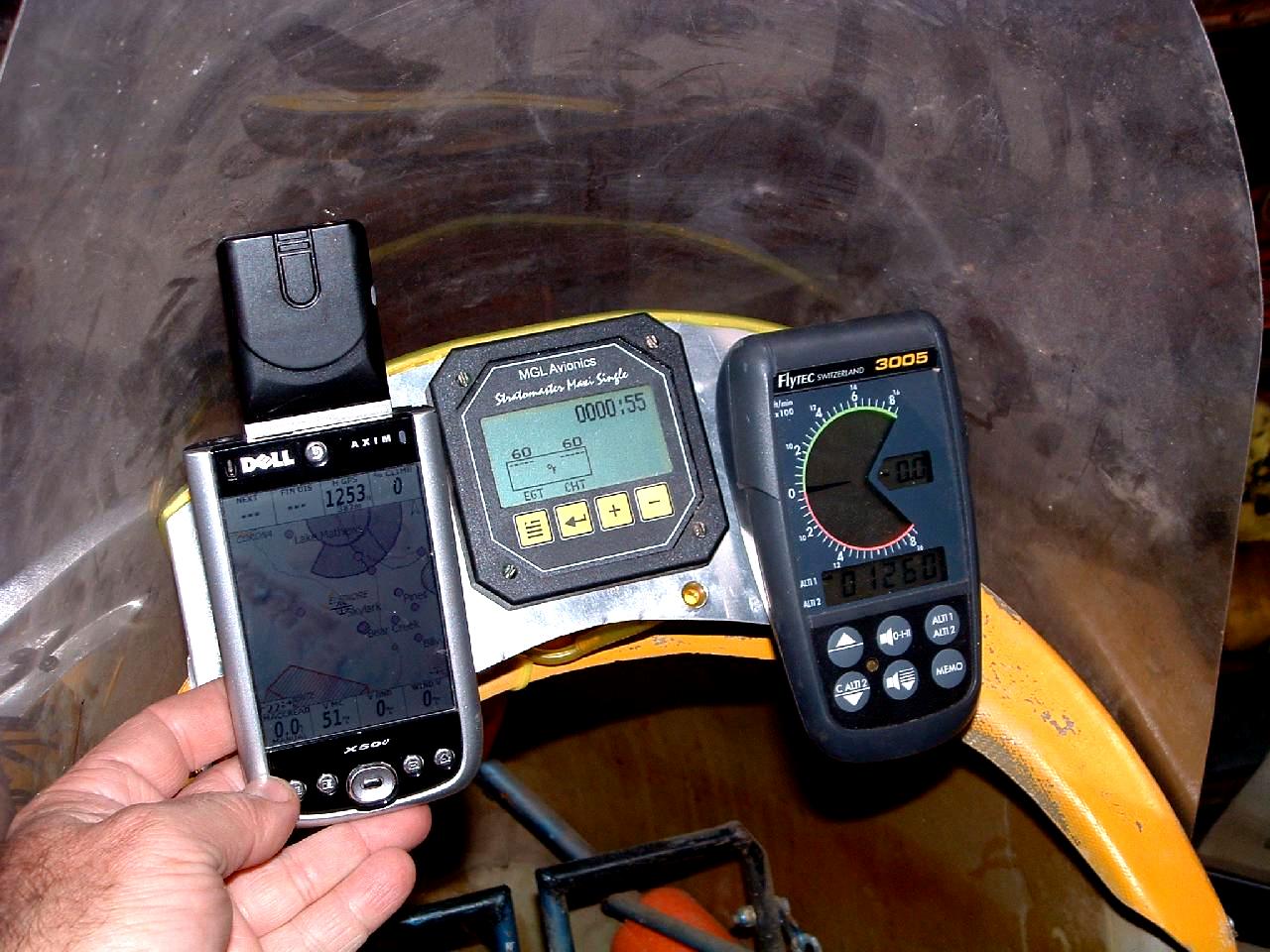

Can you believe it, I have an all digital "Glass" panel in my UltraStar ....no analog instruments here...times have changed.

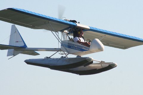

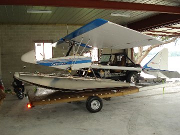

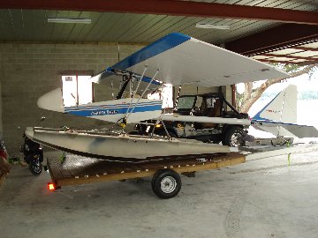

I can only speak in regard to a Firefly on floats with a 447.
Take Off on Glassy water------- 150 ft
Climb at Sea Level ----- At least 900 fpm
Handling ----- quick and nimble

Mike, the Firefly is a VERY Mission Specific aircraft, It was designed from the tires up to :
Be Part 103
Use a 447
Be exciting to fly
It is one of the few aircraft that meet that goal. (probably the only one)
The Part 103 allowance
Aircraft 254
Floats 60
BRS 24
____________
Total 338
Mine weighs 337
A 447 vs a 503 is not an issue of too much power, it is one of too much vibrating mass.
There is "Firefly" designed to use a 503 and be registered EAB. It is called a Firestar II.
If you get a chance one day fly up to Bartow Airport and I will pick you up, It's about 3 miles. I can strap you into a Firefly with a 447 and a 60# handicap of floats.
"It's not the size of the dog in the fight, It's the size of the fight in the dog." Mark Twain
(My apologies to Bob N. if I got that wrong)
Steve B
Firefly 007/Floats
