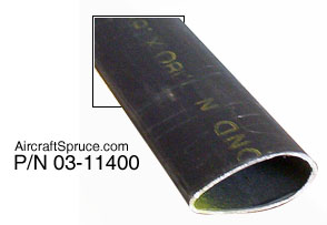

Has anyone tried the "Streamlined Tubing" from aircraft Spruce for the wing struts? A little stream lining and no fairing to deal with.
Kevin

I was thinking of using myself but it is a little pricey.
Another 701 builder told me he thought there was a tremendous amount of drag
created in the struts and anything to help would be a benefit. But I think
there over $100 for like 6 ft.

They look good and they are tremendously strong but they don't do a lot for streamlining other than in terms of appearance. I have them on an Excalibur ultralight and the plane still acts like a sheet of plywood turned flat to the wind.

Wow so the 701 must be a double sheet of plywood Very Happy
I didn't check the price.I think the ratio is like 3:1 length to width for fairings so they are a little short.But they have to be better then round tube.

I can't remember where I saw it but one of the ultralight sites sells PVC streamline fairings that slip over the structural tube. The only downside - besides the weight - is that you can no longer see the structural tube for visual inspection without removing the fairing.
You could also make a single ply glass/epoxy 3:1 teardrop fairing that would overlap and tape in place so that it could be easily removed for periodic inspection.

Fairings are easy to make out of Al, but I like the idea of not having fairings. They just seem fragile, funny really, when you consider that I'm build a plane out of big pieces of shim stock. The PVC ones would be more durable I suppose.

I am a occasional list reader and I saw your question about using streamlined struts (I haven't yet figured out how to post, so if you wish, you can cut and paste this to the list, it is a good question and I haven't seen these issues discussed previously).
I fly a 701 with streamlined struts. The struts are made of extruded, anodized, 6061-T6. I do not think extruded struts offer any considerable aerodynamic performance advantage over the steel tubes with fairings, but . . . these struts are really very nice aesthetically (especially when up close). I am currently building an 801 and I am installing similar extruded aluminum struts on it as well. NOTE: The 801 will obviously need bigger, beefier, stronger struts than a 701.
Changing over to the, more refined, extruded aluminum strut is not a simple undertaking. Here are just a few considerations:
First and foremost is SAFETY, you must ensure that the strut material and extrusion design is approved by an engineer so they are structurally adequate. My advice here is to contact Mark Townsend at Can-Zac Aviation Ltd. Can-Zac has recently done some development in this area.
Once you have extruded struts that you know are adequate from a safety standpoint, the biggest challenge is to engineer and then create the attachment pieces that will anchor both ends of the struts to the underside of the wing and to the fuselage respectively. To solve this problem, you will most likely need the help of a talented machinist who is willing to do some creative work. One of the machining challenges here is to establish (and then cut) the proper angles for the mounting-slot in the attachment pieces. You will find some difficult compound angles and depending on accuracy of the airplane's construction, the angles may differ side to side.
Next there is the issue of the jury-struts. All of the same design/engineering/machining considerations, noted above, also apply to the jury-struts. Remember that you will need a compression block inside the hollow extruded main strut so an attachment eye-bolt for the jury-struts can be tightened without compressing and deforming the walls of the main struts.
I estimate that this one refinement added at least a month to the build time and several thousand dollars to the cost of my 701 and a bit more to my 801.

The struts in question are 4130 chrome-moly. I just like the idea of having the shape and no fairings. I don't think that they are even as low drag as a fairing. I just don't like the look of fairings. I have not gotten to the the point were these decisions need to be made. I will consider structural integrity carefully, when the time comes.

Please be advise that Wicks has a limited amount of DRAWN 6061T6 streamline tube in 4 or 5 sizes. This could be considerably lighter than the Carlson strut extrusion depending on size. Length is also not limited like the Carlson parts. Also the drawn tube does not have the "pad" on the inside making flat an parallel mounting interface - you will have to create something to affect the same result.
A Merry and Blessed Christmas to all!

I don't understand "pad" and flat on parallel"
Kevin
"Also the drawn tube does not have the "pad" on the inside making flat an parallel mounting interface - you will have to create something to affect the same result."

The extruded strut forms from Carlson are teardrop shaped on the outside but in the area of maximum section thickness there are flats on the inside that are parallel to each other so that when you clamp on a block or whatever there is maximum surface contact. In those areas the wall gets thicker because the outside is curving and the inside walls are flat and parallel.
The drawn tube is just like circular drawn tube except that the section is similar to streamline steel strut tubing (very nearly constant wall thickness). When you make the attachments for the end fittings they need to be shaped like the inside of the drawn tubing or some consideration given to stability of the joint.

So... you need to make a plug to fit inside, to bolt to the wing?
