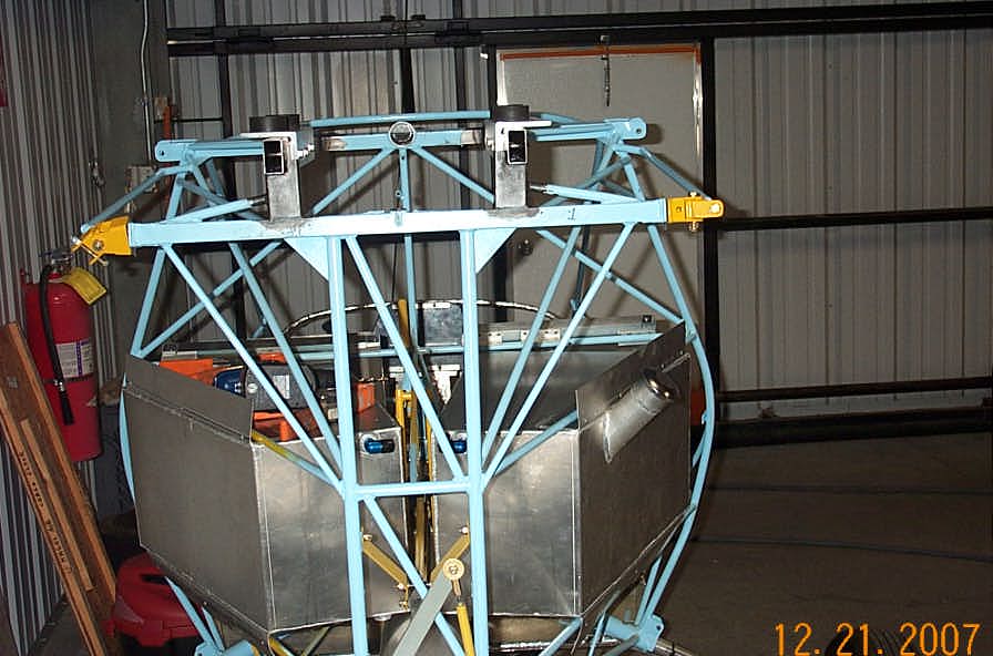

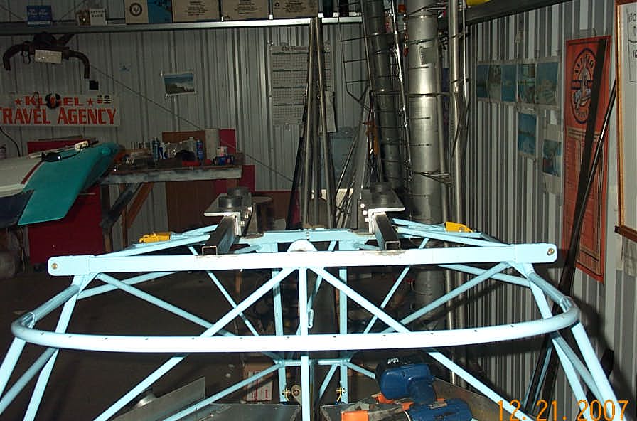

As I mentioned earlier folks to those who are interested, here are some of the missing pix of the bottom mount rails. All hardware is SS so after painting I will never have rust streaks from the bolts. I need to now have the motor sit on top of this and then adjust it to center and then drill for final placement. In future if the motor need to be canted for whatever purpose it will be simple to purchase the bottom Angles .25 6061 alum from Spruce and adjust as needed. The angles are fairly inexpensive from spruce and they cut them to length for you, I think its something under 5 bucks per foot. The rubber biscuits are from NAPA for $2.50 each. Not expensive at all even for us on a budget. The bolts that will fasten the whole thing together will be stainless as well and fairly robust, I will make sure they fill the holes in the rubber donuts 5/16 comes to mind but ain't sure yet.
Merry Christmas
Ron
Arizona

Ron, You might want to consider welding compression tubes into your frame rails so they don't collapse the rails when you torque down the engine mounting bolts. The old mounts on my Mark III had rectangular tube spacers without compression tubes and it was never possible to really tighten the through bolts. The result was that all the pieces fretted against each other.
Just a thought.
Rick

Thanks for keeping us up to date on the Suzuki install, especially the photos. I have always been very interested in automotove/motorcycle engine conversions for aircraft. One comment I have, for what its worth, is to be careful of stainless steel bolts in high stress locations. Garden variety stainless bolts have about 1/3 the yield strength and 60 percent of the tensile strength of Grade 5 fasteners. In your application, it looks like you have the freedom to oversize the bolts, so you could go with stainless but use larger sizes. Unless you want to do a full stress analysis, I would look at applications with similar stresses (eg. same engine weight) and then if using stainless, go with bolt diameters two sizes larger than you would with a grade 5 or 8. Or you could go with high strength stainless like A286.

I decided against any vertical drilling of the tubes. The hols will be through the aluminum only and with just enough clearance to be able to tighten the nut on the bottom side of the Angle, about 30% of the donut will rest directly above the rail. the rest will be a bit outboard on the angle. As you can imagine I spent quite a bit of time playing / thinking about it. This is as most Kolbs are a prototype, and its built to be as robust and as simple as possible. I already know of several different ways of making the mount, not necessarily better. I do think that this for now is probably the least complicated way of doing it. However all along I did not want to drill any holes in the rails, I finally settled on 3 of .25 holes for the bolts through the middle of the rail as you see in the pix. As that area is little stressed vertically and the angles on top will transfer loads all along the rail. I did initially almost go and do what you are proposing though.

As you can imagine,
I thought about that as well. The bottom rail bolts are in shear load mostly and each .25 is rated iirc to min of 125000 psi. In other words .75 = .25 x 3 =.75 is worth about 93000 pounds per side. as I have two sides I think it looks like I will need about 186000 lb of force to shear them. There is nothing on the Kolb that will stay on if I am ever near any crash load like that including me. The upper bolts will also be mostly in shear but they will need to transfer force to a larger area via the rubber and the angles. So that's why they are much bigger size for the top.
But will see, I may change everything right after the first time I fire the engine up.
Ron

Now that I look at the numbers, I agree they look pretty good. I am often guilty of over thinking things, but I believe it usually ends up being for the best. The calc I did comes out differently but still looks favorable. The minimum tensile strength I've seen for ordinary 304/347/316 is 75000 psi. Shear failures occur at 50 to 60 percent of tensile strength, so I used 37500 psi. The shear area of a .25 inch fastener is .049 sq-in, so the shear load each can handle is 37500 x .049 = 1840 lbs. Still a big number. What has always concerned me about ordinary ss bolts is their yield strength is only about 40 percent of tensile. This means they can stretch and therefore loosen up at less than half the rated tensile load. Probably like most of us, I am used to being pretty conservative since real life is usually more complex than the calcs assume. I am not familiar with iirc - does that mean strain hardened? I see those are rated to 100 ksi yield and 125 ksi tensile which is a very sturdy solution. Thanks for sharing the process with us - we all learn a lot along the way.

The photos help a bunch. I would add some gussets to stabilize those rails a
bunch more. Also weld steel over all the holes and treat with a anti rust
treatment. I agree with the suggestion of using bushings that you weld in
place and run your bolts thru. The bushings would allow you to torque the
bolts to reduce movement and better seal the rails to keep air and moisture
out.
Remember when you make major changes to the cage you become the test pilot.
Check the mount frequently thru the life of the aircraft.
