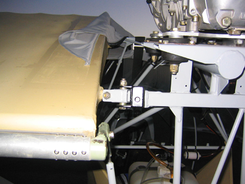

The BaronVonEvil
Joined: 23 Jun 2006
Posts: 76
Location: Walla Walla, WA.
PostPosted: Mon Dec 24, 2007 6:16 pm    Post subject: Re: How do you like your FireFly? Reply with quote
Hi Jim,
It just so happens I happen to have an extra English U joint if you want it.
I bought two for my Firestar II after I powder coated my cage and found out the wing incidence had changed. Turns out I only need one U joint to trim out the plane.
I powder coated them black because thats the color the powder coating guy was running at the time. You can lightly sand the coating and paint to match your airframe.
Let me know what you would like to do.
Best Regards
Carlos Grageda
grageda(at)innw.net
English ujoint installed
 Filesize:  162.56 KB
 Viewed:  593 Time(s)

> Mine has the gap seal removed (between wings). I am 6-01 and if
it were there, I think my head wouldn't fit in the airplane.

not out of limits, the most efficient (from a drag standpoint) way
to trim it is to raise the front of the horizontal stabilizer a bit.
You are degrading the efficiency of the wing by flying the aircraft
without a gap cover. Minimally, at least the top surface of the gap
should be covered. You might see that 1500 feet per minute rate of
climb you expected with a gap cover in place.
