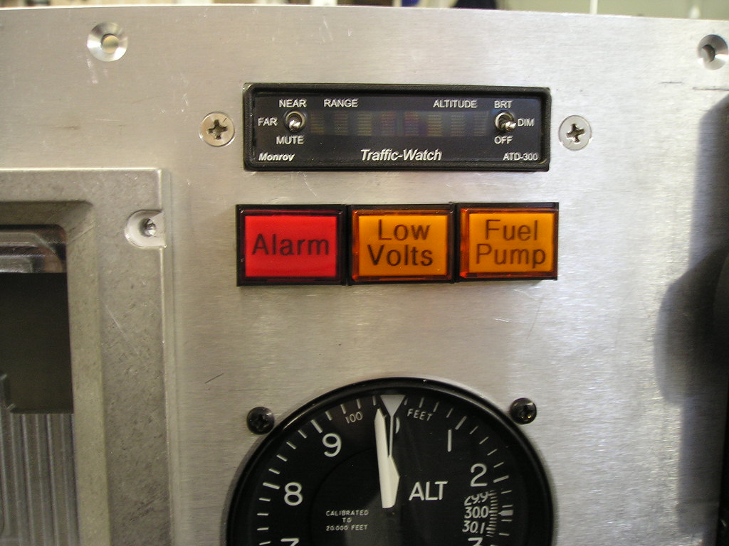

Got a picture?
Why do you need 12 enunciators? Doesn't the AFS do this already?
I did just a few using legend lights from aircraft spruce. I modified some spare bulbs I had already and made them into led bulbs. You can also buy pre-made led bulbs in this format. works good. Attached is a picture of the final result.

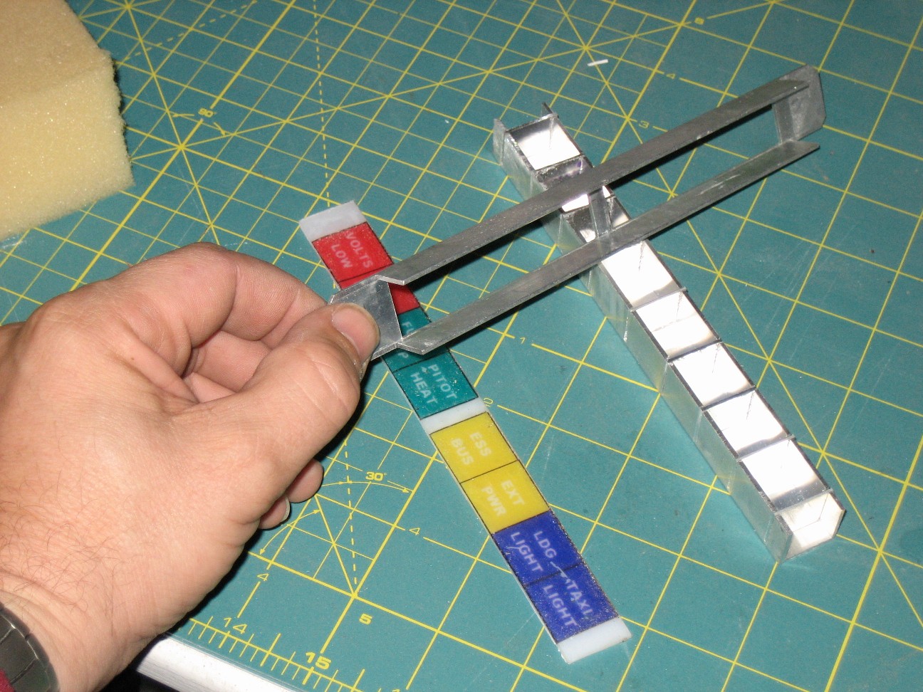

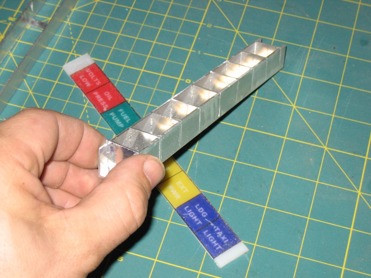

A fine piece of work! I've preserved this data in
an excerpt of the websit and posted it to:
http://aeroelectric.com/articles/Roll_your_own_Annunicator_Panel.pdf

In the document you saved to your website, you're missing the building
pictures... which are very important and are in the bottom of the Van's Air
Force thread
Carlos

PostPosted: Wed Jan 09, 2008 10:51 am    Post subject: Question about Annunciating Lights Reply with quote
Bob, it would help if you also added these pictures to the article...

Here's another take on rollin' yer own:
http://websites.expercraft.com/n51pw/index.php?q=log_entry&log_id=5126
Click on fotos for bigger view and Next Entry>> for more info (several pages) including wiring diagram, part #s etc...
From The PossumWorks in TN
Mark Phillips

PostPosted: Wed Jan 09, 2008 9:44 pm    Post subject: Question about Annunciating Lights Reply with quote
I took Mark's work as a basis, and this is what I ended up with....
Close up:
http://www.rvproject.gen.nz/photos/2007-06/Web_Img_9760.jpg
http://www.rvproject.gen.nz/dailylog/dailylog_2007-07-28.html the final look,
http://www.rvproject.gen.nz/dailylog/dailylog_2007-06-18.html and
http://www.rvproject.gen.nz/dailylog/dailylog_2007-06-19.html for some of the fabrication process.
Just another possible source of ideas.
Carl
Carl Morgan - ZK-VII - RV 7A - Inspection next Tue!

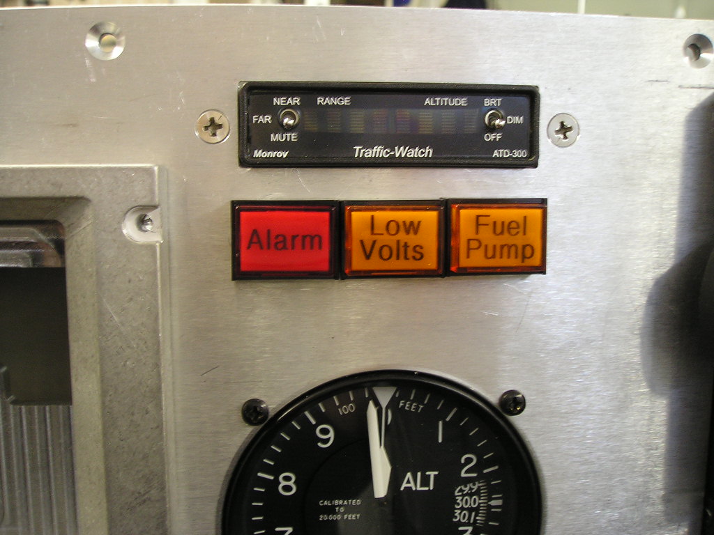

PostPosted: Thu Jan 10, 2008 6:19 am    Post subject: Question about Annunciating Lights Reply with quote
I made my panel out of Honeywell microswitches. It's not really a cheap way,
but the results are nice, and it's fairly straight-forward, with "dead face"
(labels so you KNOW the lamp is out, because it cannot be read unless
illuminated from behind). I also built a push-to-test circuit.
http://www.velocityxl.com/Electrical.htm
(just the pictures)
http://www.velocityxl.com/annunciator.JPG
http://www.velocityxl.com/press_to_test.JPG
http://www.velocityxl.com/IMAGES2/GRT3.JPG
I bought mine from these folks http://www.fmw411.com/
Brett
