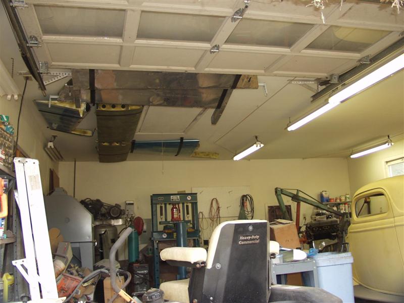

Hey John,
I liked your idea of getting parts UP out of the way, so today I hung my RV-10 tail feathers with strapping material. I just rolled each end about 5 layers and ran a sheetrock screw through it into a ceiling joist.
This will be my tail section, but for now we're working on my friend's RV-10. After I finish the '33 Ford streetrod and get it out of the way, that space becomes a paint booth and I'll paint his section by section. And THEN I'll get back to mine!
What did you ever do about your dent? As soft and thin as this aluminum is, I was curious if you tried the suction puller.
Later, - Lew
