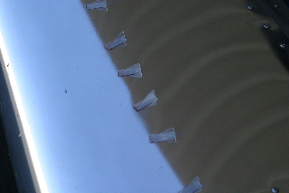

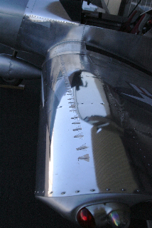

I assume the XL is similar to the HDS and it was impossible to hold
the nose up on ours after touchdown. We solved that problem by
placing VG's on the bottom side of the horizontal stabilizer. With
the VG's there, you could aerodynamic brake down to about 20 mph.

I have an HD which has a more similar wing to the XL and find that holding the nose up is not difficult if you come in at a little higher speed.
Stan I am interested in the HDS wing and wondered if you also put vgs on the wing and what kind of differences did you notice in climb and stall speeds.
John

You'll find the details of my flight test with VGs on my 601 HDS in the archives. They are well worth the money.
Dave Austin 601HDS - 912, Spitfire Mk VIII

For info on the HDS wing with VGs have a look at http://www.stolspeed.com/content.php?id=57
JG

It really got me to thinking about the aerodynamics of the horizontal stabilizer. Please indulge me while I ramble about this.
ZAC told me that the stabilizer airfoil is symetrical. Since the stabilizer exerts a downward force to balance the moment of the engine around the aircraft cg, the symetrical airfoil must be angled slightly downward to generate a downward force with neutral trim. After touchdown, with the nose up, the stabilizer would be angled upward, generating an upward force that would rotate the A/C around the mains, pushing the nose down. So, to hold the nose up after touchdown, you would need to pull the stick aft, forcing the elevator up. And, what Stan is saying, is that VGs on the underside of the stabilizer will increase up-elevator effectiveness (apparently) by reducing boundary layer separation on the bottom of the elevator. That all makes sense to me now.
So, I would like to ask Stan the usual questions, how many VG's? Where are they on the stab? Do you have any photos? Thank you for posting your experience.

Terry:
How many VG's? I believe there were 42 VG's on each side. I used the
same spacing and template on the underside of the stabilizer as I did
on the wing so there would have been about 2.5" between them. They
were placed at 10% of the chord. The below photos are of the wing.
Guess my neck was already stiff from working upside down applying them
so I skipped the photos.
Stan

elevator, to a net downward force. But, if I interpret Stan's results
correctly, the unmodified zodiac elevator is incapable of holding the nose
up after touch down. But, Stan's addition of VGs to the underside of the
stabilizer, increased the effectiveness of the elevator on Stan's
airplane. Then he could hold the nose up until he slowed to 20 mph.
So that's what it looks like to me.
My understanding of VGs is that they function by causing the laminar
boundary layer over an airfoil to transition to a turbulent boundary
layer. Turbulent boundary layers (for reasons I do not understand) stay
attached better than laminar boundary layers. And by staying attached, the
airflow over the airfoil exerts a net lower pressure on the bottom of the
stabilizer/elevator (think Bernoulli's law), thus effectively pulling the
tail down (and the nose up).

And, now I see that VGs on the underside of the stabilizer, can delay the
low speed stall of the stabilizer airfoil that occurs at high angle of
attack (i.e., nose up upon landing). Thanks Paul, Stan, Tony, and all who
responded. I think I can build a better airplane now, and, stabilizer VGs
will be part of it. I think I'll head for the shop and see if it has warmed
up from this morning's low of 34°.
