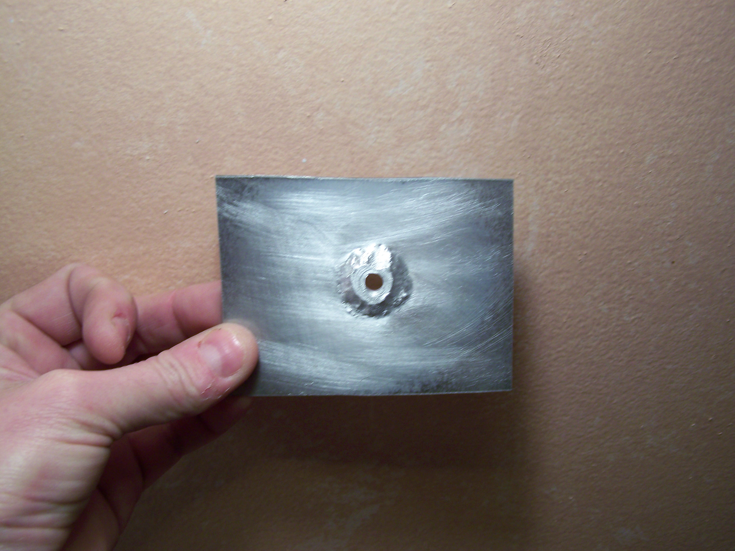

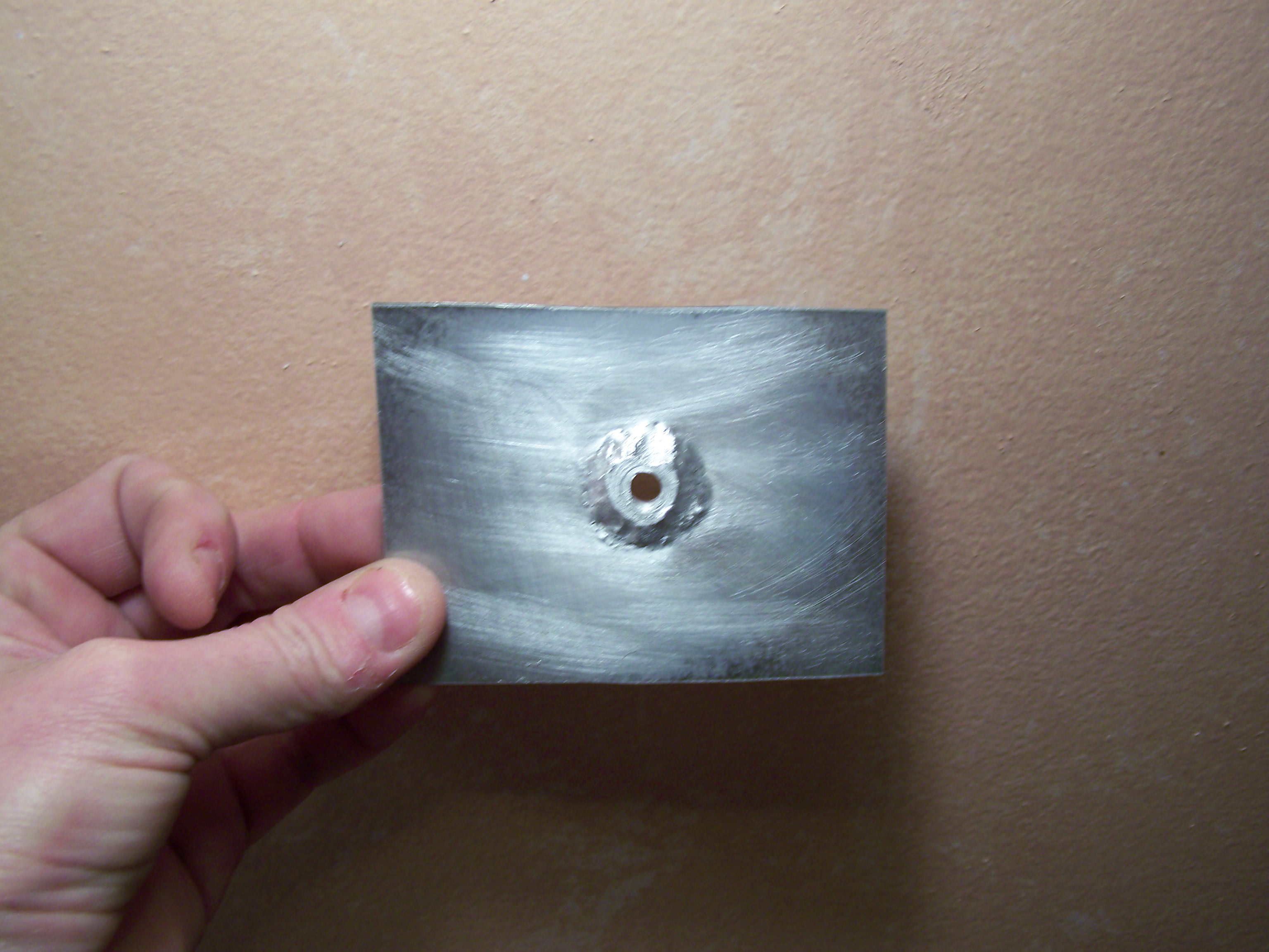

Here's some of my aluminum welds. Just some practice coupons. I did this one tonight. I think it's starting to get tank worthy, especially being that I'm now able to casually reproduce the results over and over.
This is .032 5052 alloy with a .063 1100 alloy filler and a 00 tip on a Harbor Freight oxy-acetylene jewelers torch and about 3 psi on both oxygen and acetylene.

Looking good Andy. Remember to relax, breathe and watch the puddle.
Don't know if I told you but I worked with Ron Fournier for a year in the 70's. He really knows his stuff.

Thanks. It seems to be one of those things like riding a bike. Hard at first, but a lot more second nature once you start having some luck and then all of a sudden you gain about 90% of the knowledge all at once, you get in the zone. I gotta work on finesce now at master the other 90%. LOL
That's pretty cool. Didn't know you worked with him. Yeah, he and the Tin Man seem to be pretty knowledgable.
My welds are still a little rough, but I don't see any pinholes, and I'm not melting away a ton on metal now, so that good.

That is a nice pretty looking seam Andy. Have you tried to separate them to see how strong they are. I may still have in my email archive a message from another builder who gas welded his tank and one of the things he reported was that after he managed to get a nice weld, the parts where weakly joined and it took him a lot more practice to figure out how to make it strong.
Thanks for keeping us posted, I'm almost settled on riveted tank with pro-seal but I'll follow your steps if you get it to work with a reasonable amount of learning time. I will be reaching the tank build point by around summer.

I've cut others open and the penetration is pretty good. I'm still practicing. About ever 4 days I'll go out and weld some more and each time they get better. It's almost like I just have to digest for a few days what I learned.

ashontz
Joined: 27 Dec 2006 Posts: 723
Posted: Sat Jan 19, 2008 7:21 am Post subject: Re: Welded Fuel Tanks Update |
Tried a tank fitting. Fitting was about 3/4 inch diameter flange (now less) with a 1/2 shank, made it up on the lathe real quick and drilled a half inch hole in the .032 sheet. Next time I'll put even more flux on it and flux the back side. Actually not to bad though for a first try. Then I drilled the hole.
Interesting, on the thicker stuff it wasn't so obvious it was already molten. As soon as I poked at it with the rod is flowed. I mainly heated the fitting, not the skin. Maybe 25% of the flame or less was on the skin. More like broiled the skin and heated the fitting flange.
