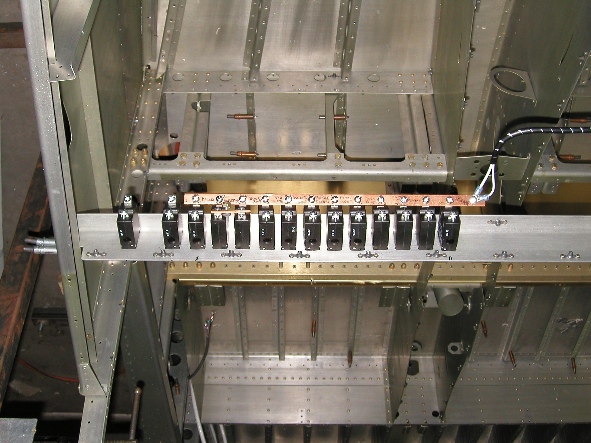

two 30 or 35s in parallel with a short copper bus bar between them. Easy
attach of the fat wire.

Posted: Thu Jan 31, 2008 5:33 pm Post subject: Alternator Circuit Breaker |
| Quote: | Passing 'big' wires through the firewall bothers me and the fewer possible makes me feel better. That is why I am considering possibly in front of the firewall.
In the RV-10 with a rear mounted battery, you have to pass at least ONE "big" wire through the firewall. Well ---correction, I don't have ANY "big" wires going throught my firewall. I only have an 8AWG wire from the alternator going through my firewall. Not even the main battery to starter contactor cable. I use a thru bulkhead connector show on the attached picture. On the firewall side is attached the starter contactor as shown. On the cabin side is attached the main battery cable and the (smaller) battery cable to the buss.
William
