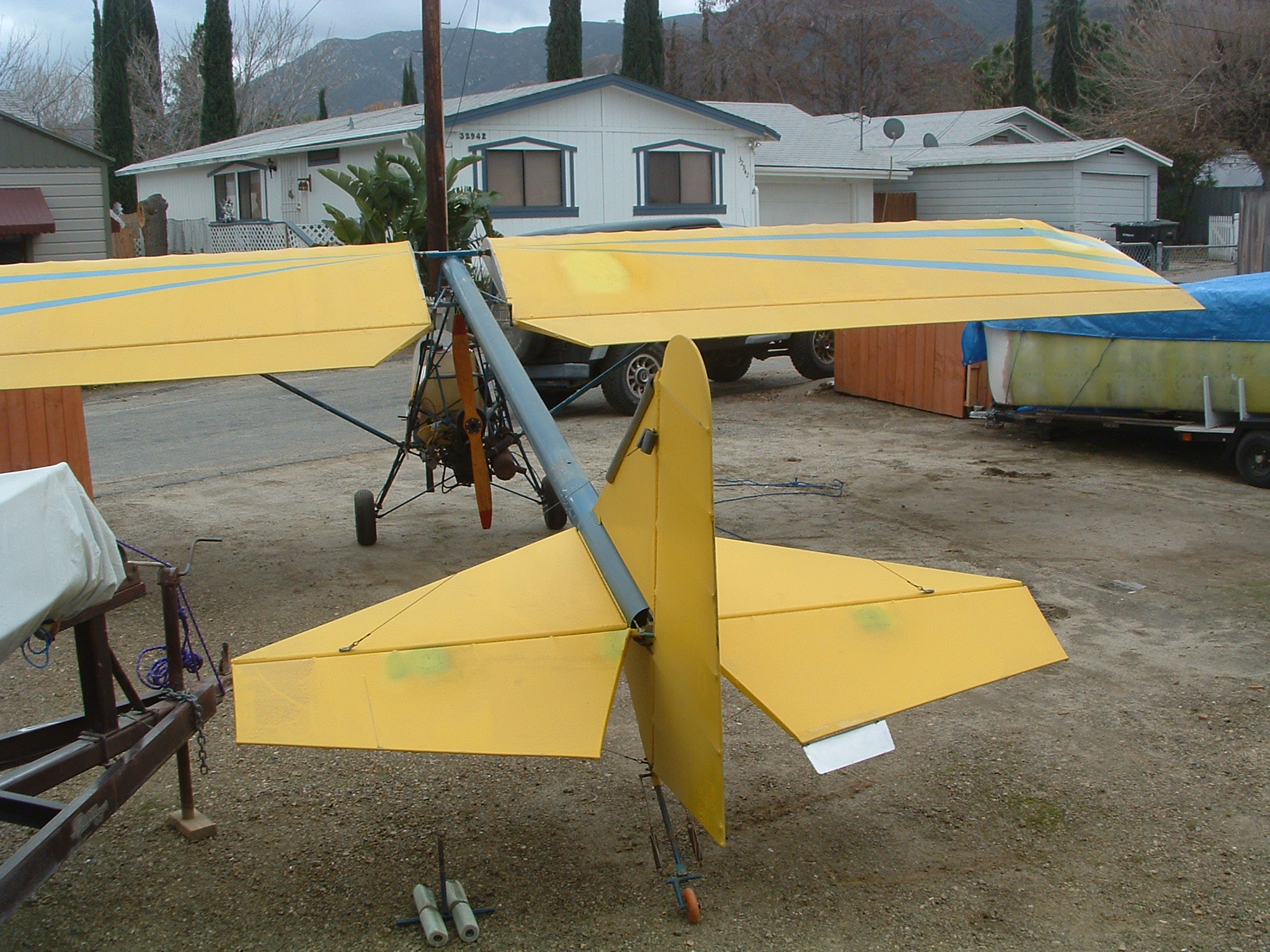

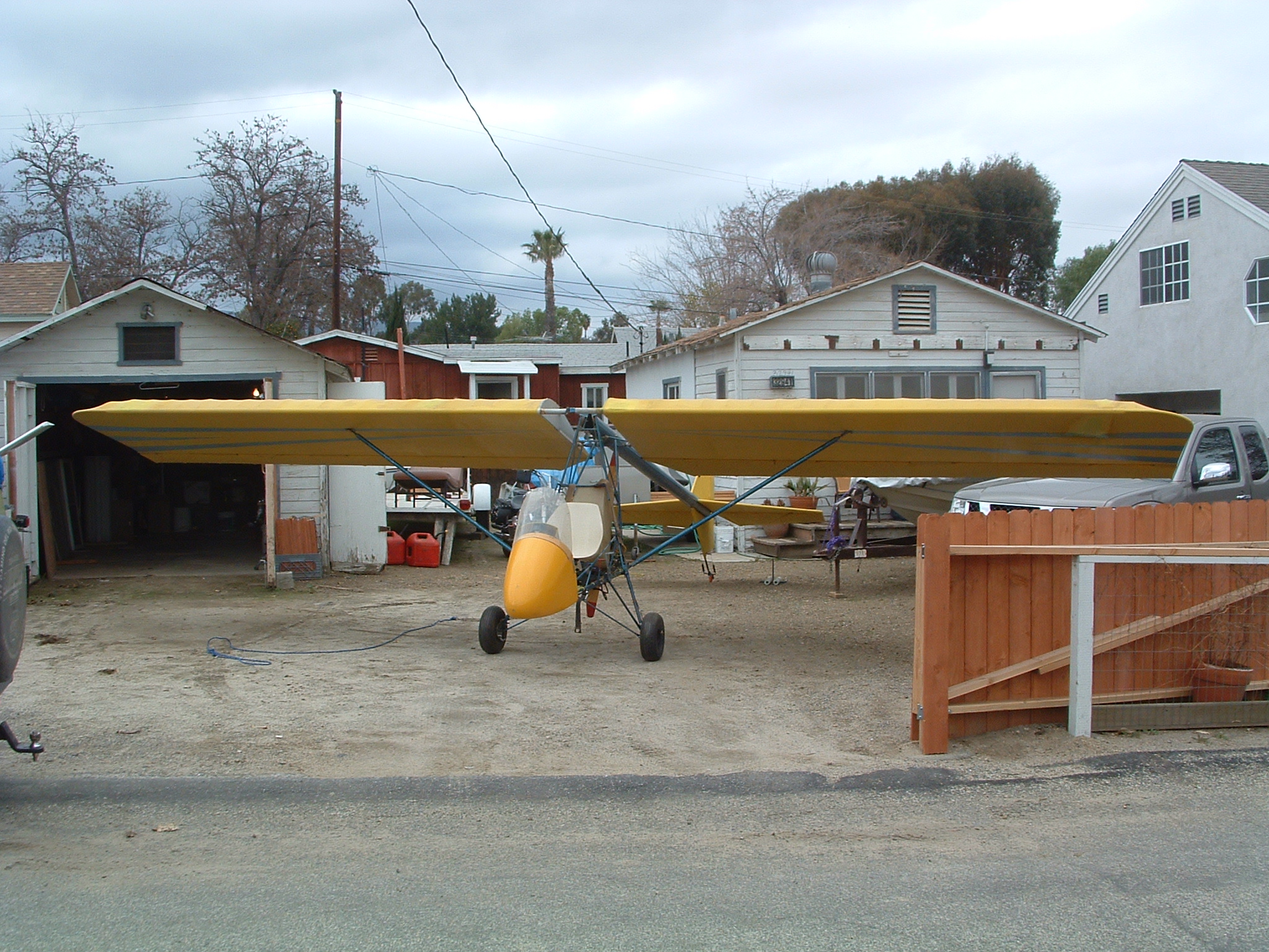

In the meantime, here are some pics.

At 10:05 PM 2/5/08 -0800, you wrote:
| Quote: |
Ray,
Looks like your Ultrastar has negative dihedral.
Should make it a fun aircraft to fly.
Jack B. Hart FF004
Winchester, IN

jb92563
Joined: 23 Mar 2007 Posts: 314 Location: Southern California
Posted: Wed Feb 06, 2008 7:25 am Post subject: Re: Ultrastar Update |
I'll double check the dihedral with my laser level once I get the proper bolts, but if there is any, its probably because I used undersized temporary non AN bolts to assemble so I could take an inventory of what I needed to buy.
Thats what resulted in a slight negative dihedral.
Same thing on the elevator hookup as they were noticeably mis-aligned with my temporary undersized bolts.
Actually, having a slight bit of negative dihedral is not a bad thing, just makes the aircraft more neutrally stable in the roll axis......makes turning more effortless as it will resist rolling out better....no big deal really, and it helps considerably in crosswinds to resist weather-vaning.
Funny thing is that every aircraft I have owned have some V in them as I have a owned 4 V-tails so far, perhaps the Ultrastar is feeling left out and trying to conform as well
