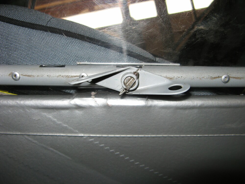

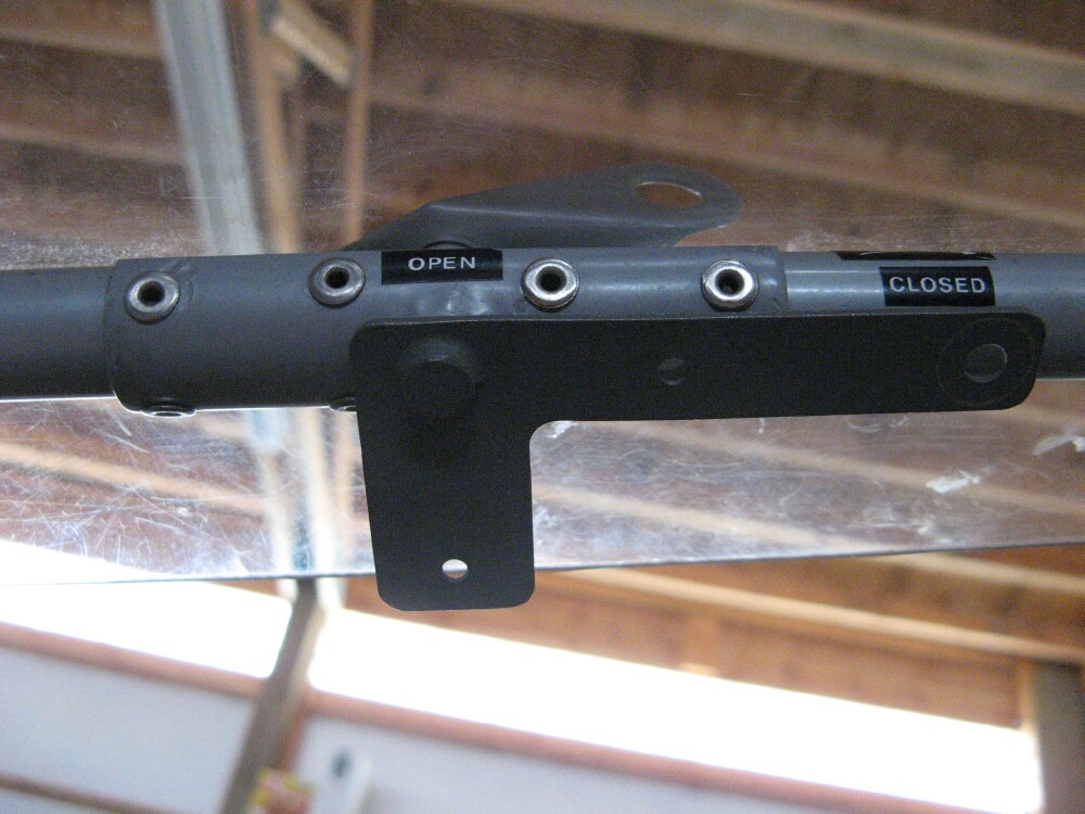

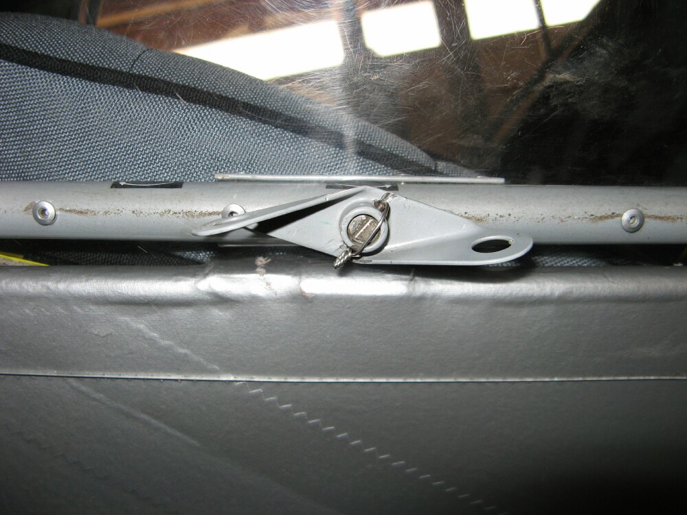

Okay, I,m back with some door latch info. My 1994 Classic 4 manual was delivered with one page of door latch instructions from Denny aerocraft that no way resemble the parts shown.
The attached pictures show the latch and the first page of the five pages of instructions I received later that match the parts shown. The parts include a round black plastic knob that I did not install. Leon, let me know if you need hard copies of these instructions.
 Filesize:  164.7 KB
 Viewed:  647 Time(s)
 Filesize:  164.56 KB
 Viewed:  621 Time(s)
