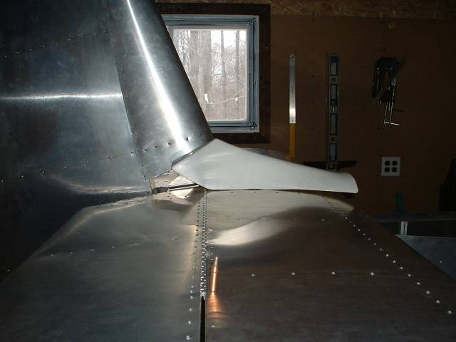

naumuk(at)alltel.net Guest
Posted: Sat Feb 23, 2008 7:24 am Post subject: Rudder cut-out |
Here's a picture.

larry(at)macsmachine.com Guest
Posted: Sat Feb 23, 2008 9:46 am Post subject: Rudder cut-out |
You're right Bill,
but you do need to put the rear top skins on before you get into fitting
the saddle. Then you have the dimensions
needed and the estimate of fit to make it work. Don't know anyone
that's succeeded in putting it on before the
rear top skin. Even trimming the rear top skin for the stab is a pain,
but that needs doing too.
http://www.macsmachine.com/images/rudder/full/rudderfairing.gif
http://www.macsmachine.com/images/rudder/full/fitfairing.gif
http://www.macsmachine.com/images/rudder/full/ruddernose.gif
The rudder, elevator bellcrank and rear top skin fitted for the nose of
the stabilizer, then the saddle.
http://www.macsmachine.com/images/controllinkages/full/runuprear.gif
The saddle is a bitch to get in until you learn to spread the sides of
it as you draw it back under the rudder far
enough to get the front edge under the rear top skin. You have to not
trim too much from your rear top skin to
allow fasteners and rudder gap and bellcrank their proper clearances. It
gets close with this piece.
http://www.macsmachine.com/images/controllinkages/full/bhorn.gif
The two screws you see on each side screw into tinnermans on a short
standard angle. The front of the saddle
is fitted with 3 tinnermans and I have screws going thru the rear top
skin and into the tinnermans. That was my
solution to the forward and rear side attach points.
Hope this helps a bit,
Larry McFarland
