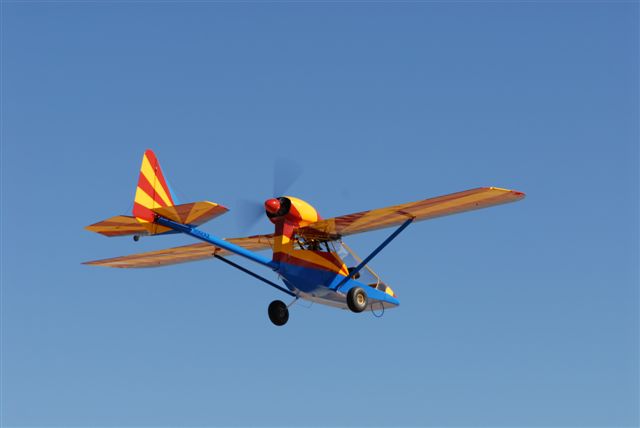

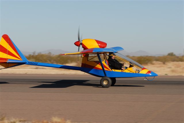

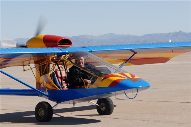

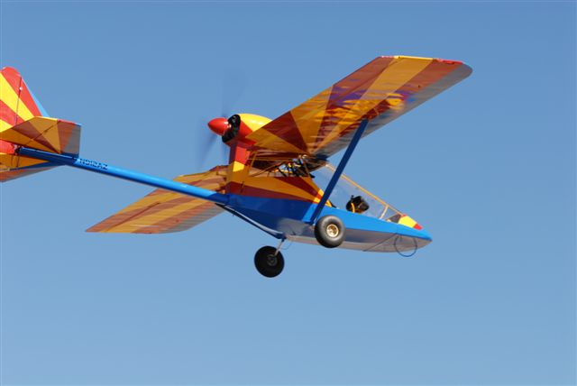

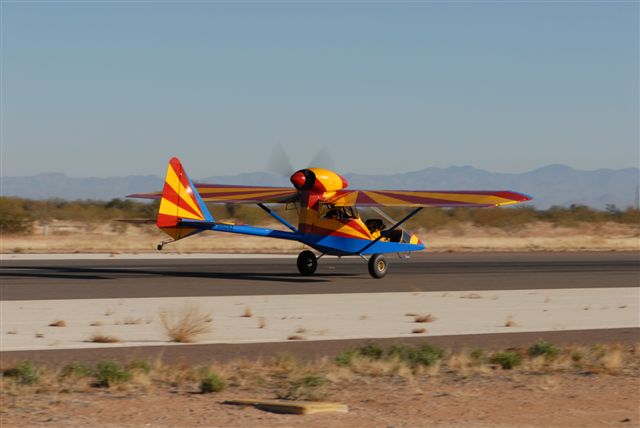

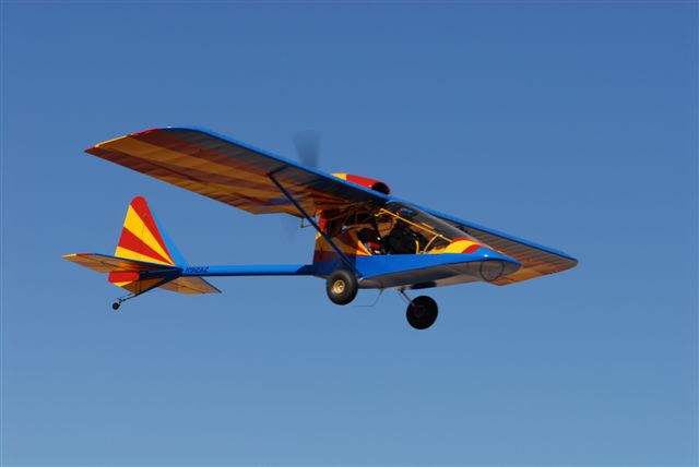

I am just getting ready to start building a cowling for my MK3x. I'm still a good ways off being ready to fly but am taking this time to build the cowling while I have the plane at home were all my fiberglass etc are. My engine is the water cooled VW with re-drive. The cowling will have at least two NACA scoops, one for each cylinder set. There will be another air intake for the two radiators and oil cooler. I'm looking at ways to maybe having a quick transition from wings leading edge to the rear of the engine cowling. I would really rather not have a cowling that looks like a jet engine, which will be hard to do since the engine is mounted like it is on the cage. I will post pics when I get something to show. I've always felt that the Kolb needs to be cowled.

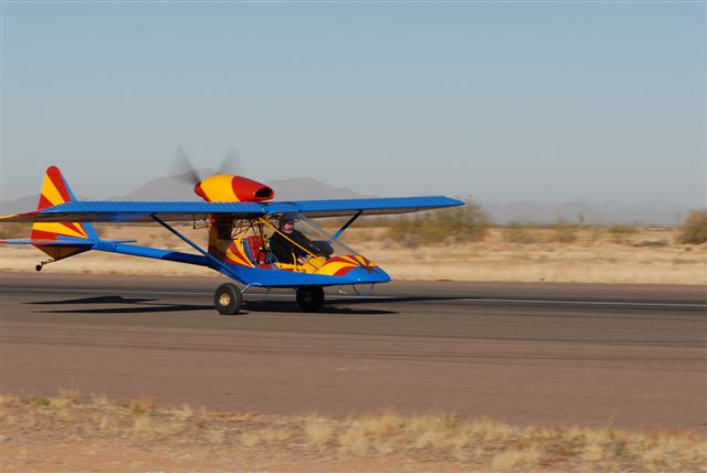

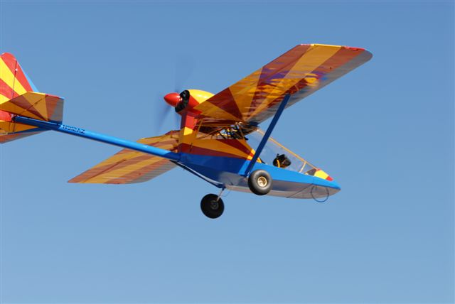

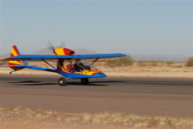

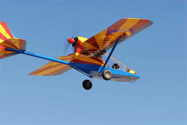

PostPosted: Mon Feb 25, 2008 7:54 pm    Post subject: Engine cowlings Reply with quote
<<DSC_0241.JPG>> <<DSC_0065.JPG>> <<DSC_0067.JPG>>
<<DSC_0070.JPG>> <<DSC_0143.JPG>> <<DSC_0145.JPG>>
<<DSC_0146.JPG>>

slyck(at)frontiernet.net
PostPosted: Mon Feb 25, 2008 9:47 pm    Post subject: Engine cowlings Reply with quote
On 25, Feb 2008, at 10:51 PM, Nelson, Craig wrote:
.. I just like the way it looks....
 Uncle craig
So do I.
BB
