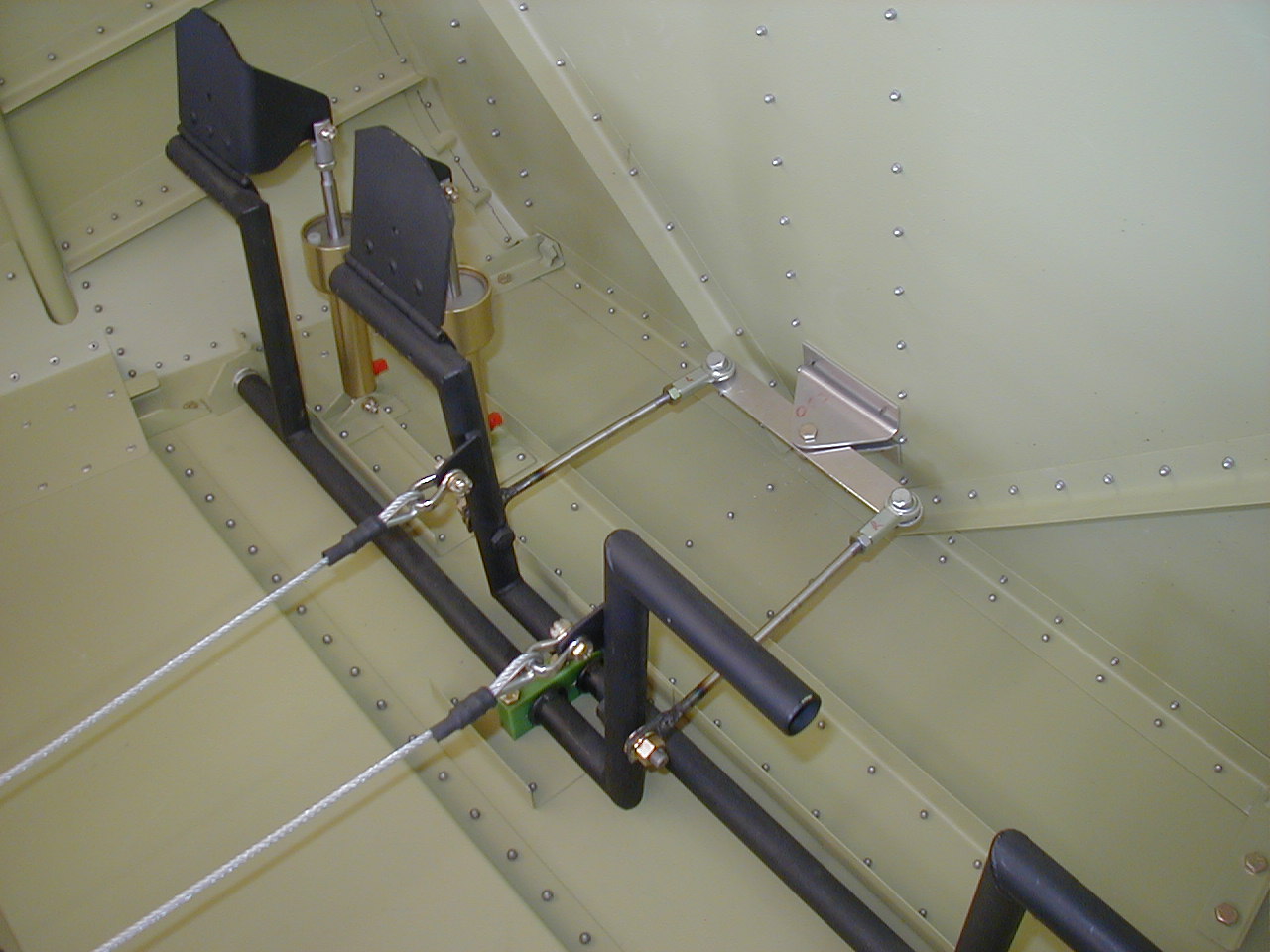

Another neat option for keeping the pedal from flopping is this balance bar (picture attached) that another TD builder came up with. I saved the picture off a website for future reference and don't remember who the builder was (owner of photo: feel free to identify yourself and claim your elegant solution!).

Looks like a picture from my site. Here are some more: http://n601bz.com/ch601xl/Fuselage/Control_Cables/043005.htm

The V block on the nose gear (and maybe the two-spring approach for a TD) would self-center. I don’t think the balance bar would do that. Is that true and is it a real issue?

In flight the air flow over the rudder tends to center the pedals, on the ground keeping the airplane going in a streight line tends to keep them centered (assuming of course that everything is correctly aligned).
