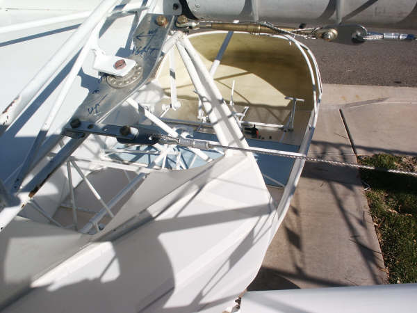

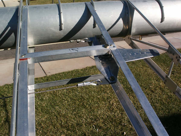

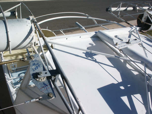

Kolb guys,
Seeing as how I had laproscopic surgery this past Wednesday (hernia), I am laid up, being an email vulture. My wife has threatened me with severe bodily harm if I go out and work on my MkIII today. Sshh!! What she doesn't know won't hurt me, I hope!!
My latest creation is with the aileron control system, a deviation from the one designed originally on this plane. Again, my apologies to those that are offended at such a non-original modification( non-OEM). All I can say is, unless your plane is exactly like the plans, don't beat me up too much. I, like Fred Astair, did it MY WAY!!!
Yeah, I know it wasn't Fred Astair, it was Frank Sinatra. I was just seeing if you were paying attention. Back to my point. As I was saying, I was never a fan of the double hinge design, having to twist the flaps a little to get to the ailerons. I explored a couple of alternatives (hydraulically actuated and Morse cables), but the truth is, the one that seemed to be the easiest and most standard as seen in "factory iron" is the old tried and true pulleys, bellcranks, and cables.
Enclosed find a few photos of my latest modification. I might add this system is ROCK SOLID!! There is NO slack, the ailerons move effortlessly, and they still retain the quick disconnect ability, for folding wings. All parts were designed and custom built by me. I used authentic aircraft bellcrank bearings, cable pulleys, cables, turnbuckles, and 6061 T6 aluminum. The fact is, this is a simple design, and could have quite easily been an original system in the first place. The main thing is, I still can swings the wings, same as before.

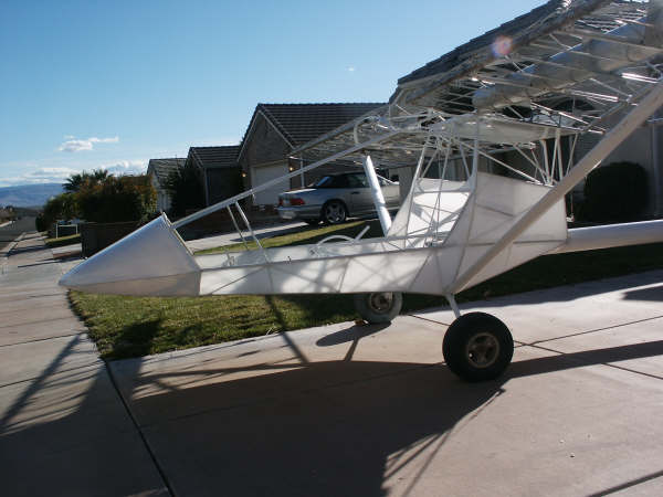

You may also notice in the last photo my MkIII Classic to MkIII Xtra conversion is coming along quite nicely. (Are you still paying attention? Read that last sentence, again.) The side-swinging doors are painted, and ALL lexan is cut and ready to install, as soon as I finish fabric and paint. (End of March, I hope) Then on to finishing the GEO with turbo installation.
I share these modifications with those of you that have an interest in "non-standard" applications. I respect those of you who maintain your desire to retain your plane "as per plans", if that's your preference. If you don't care for my mods, I understand. As Rick G said once This is experimental aircraft." I am the kind of guy that does NOT wince at the amount of work involved to accomplish what I want.
For your perusal and comments, find the following photos.

Very nice work Mike, I really like that idea ! My ailerons get " Springy " due to the long torque tubes on the trailing edge of the wing that actuate them twisting under flight loads. I get maybe 10 degrees or less aileron travel in the air, while I am getting 30 degrees or more on the ground. Your modification will eliminate this problem, and keeping the wings foldable, thats just a bonus.
Being that my plane is already flying, it would be difficult to change to a cable system, so I am trying a different approach. I am installing spades on the ailerons to bring down the forces to where the long aileron tubes do not twist anymore. I really like the idea of having a MK III with light, responsive ailerons.

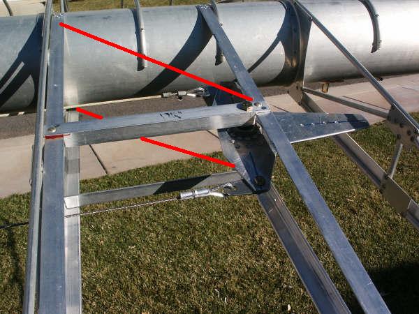

There is one thing that worries me in your aileron modification. You have four long peices of angle aluminum holding a bellcrank that are being loaded with a bending force. Even angle aluminum does not have great streingth in bend at that leingth. The forces on the cable will be several times what the forces are on your stick due to the mechanical advantage created with the stick, pulling the bellcrank inwards in with more force than you may realize. In a situation in the air, where you pull very hard on the stick , you might have enough force to bend those 4 long peices of angle aluminum inwards permanently, or at the very least get somewhat of a give and springy feeling.
I would suggest using some of that same angle aluminum to create a " Triange " that would make that area many times stronger to bending inwards, and preclude the possiblity of any springy feeling under load, or even more importantly prevent those from bending permanently inside the wing. The easiest way would be to what I have described would be to add two small peices of angle aluminum as shown in the attached picture. ( Put the same angle aluminum you have been using where the red lines are, top and bottom. )
Mike

FYI, I was going to do that EXACT reinforcement!! I just hadn't gotten to it, yet. There is a minor adjustment to the central bellcrank I need to do first. Once absolutely EVERYTHING is where it should be, then I was going to do any additional reinforcement bracing, those red lines being the primary braces I knew I would add. You are two steps ahead of me. I'm getting there.
BTW. When I ordered my angle aluminum from Aircraft Spruce, I didn't know which thickness to get, so I got the 1/8th" thick angle. OMG, too thick!! This stuff is industrial duty at this thickness. But still, it needs the reinforcement at the location you pointed out, regardless of it's thickness, just as a matter of proper design.

I am very close to having the aileron system completed. This has been a learning lesson, too, especially with regard to making the bellcranks, and most definitely trying to keep everything in line and operating smoothly.
Essentially, I have found out it is easiest if I maintain the 3 1/2" radius arm length to each side of a bellcrank. There is some geometry issues that become problematic, when I tried to vary the radius of the "swing". But, by continuing the initial 3 1/2" arm (at the rear of the center of the fuselage), I just kept that distance all the way to the last bellcrank. Pictures explain better what I am getting at.
What remains for me is to relocate the cetral pulley located in the wing gap area. It was placed too far forward to have the proper pull and push toward the side pulleys. Like I said, I learned as I went. If I get some time tomorrow, and my wife let's me (I'm still getting over that surgery I had this past Wednesday), I hope to wrap up the entire system.
I am very satisfied with the aileron control change. You can move the control stick an 1/8th of an inch, and the ailerons will move an 1/8th of an inch. The force necessary to get such action, on the ground is measured in partial ounces, or less. I will balance the ailerons, just to make sure there aren't any hidden gremlins lying in wait.
Although this has been a fairly time consuming modification, the second time around I could do it in a tenth the time. The nature of the cables is that they are loose enough not to bind, yet allow virtually friction-free motion.
By using rod ends, and pulleys, there is practically NO slack in the system, yet it operates so smoothly. If you ever got a chance to check the movement, I think you'd be impressed.
