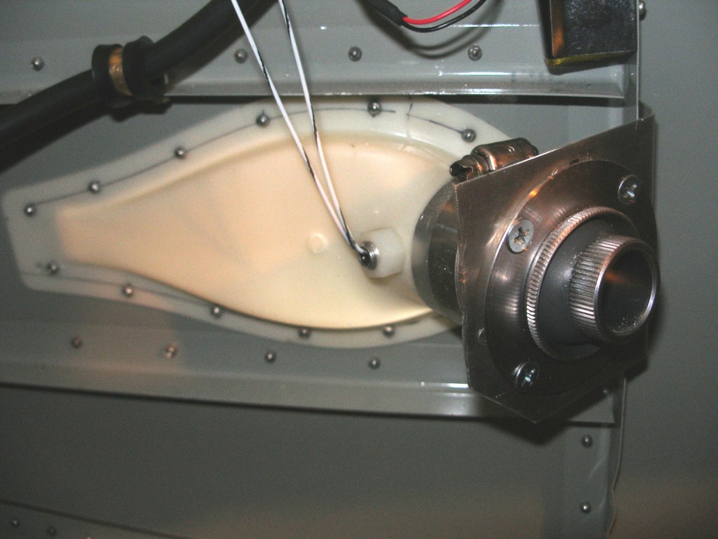

				Hans,
 I mounted mine in the right air inlet.
 Jay in Dallas 601XL N2630J "Lil Bruiser"
