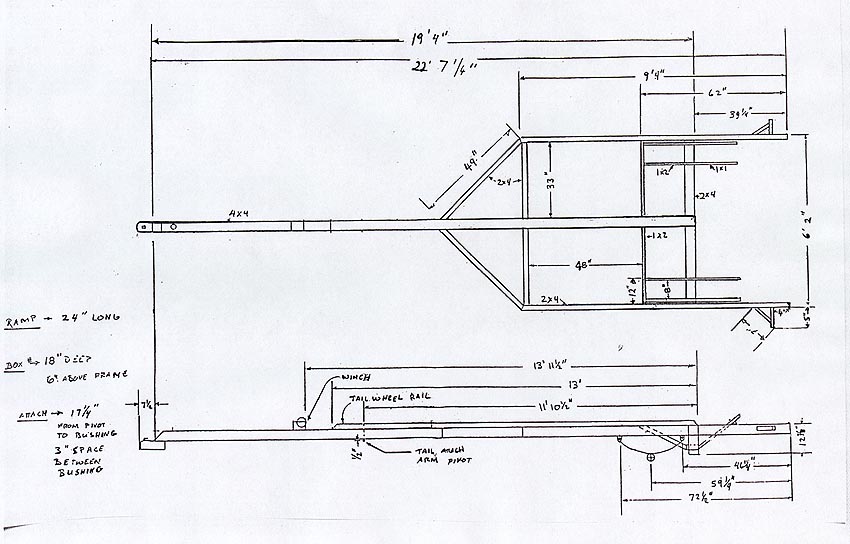

Out of pure curiosity I checked the link you posted and I found out a lot of
items have mysteriously disappeared from the Sportflight site since I last
visited it (quite a long time ago to be true!)
In the "Trailer" section a picture is listed with my name but clicking on
the link results inan error message. The image I had downloaded, more than
10 years ago, is gone. As this was the drawing of the original trailer the
factory had been using since the time Dan Denney was the owner I'm sure many
of the actual list members would like to have a look at it. Fortunately
enough I still have the original drawing stored here, plus a copy of my
commentaries I had included for the original posting.
Anybody using this drawing should be aware that it stems from the
pre-SkyStar era, and thus some of the dimensions contained in them may still
relate to some superseded model versions and thus be out of date. Therefore,
all critical dimensions should be carefully checked against those of the
actual airplane before cutting any metal
Enjoy!
