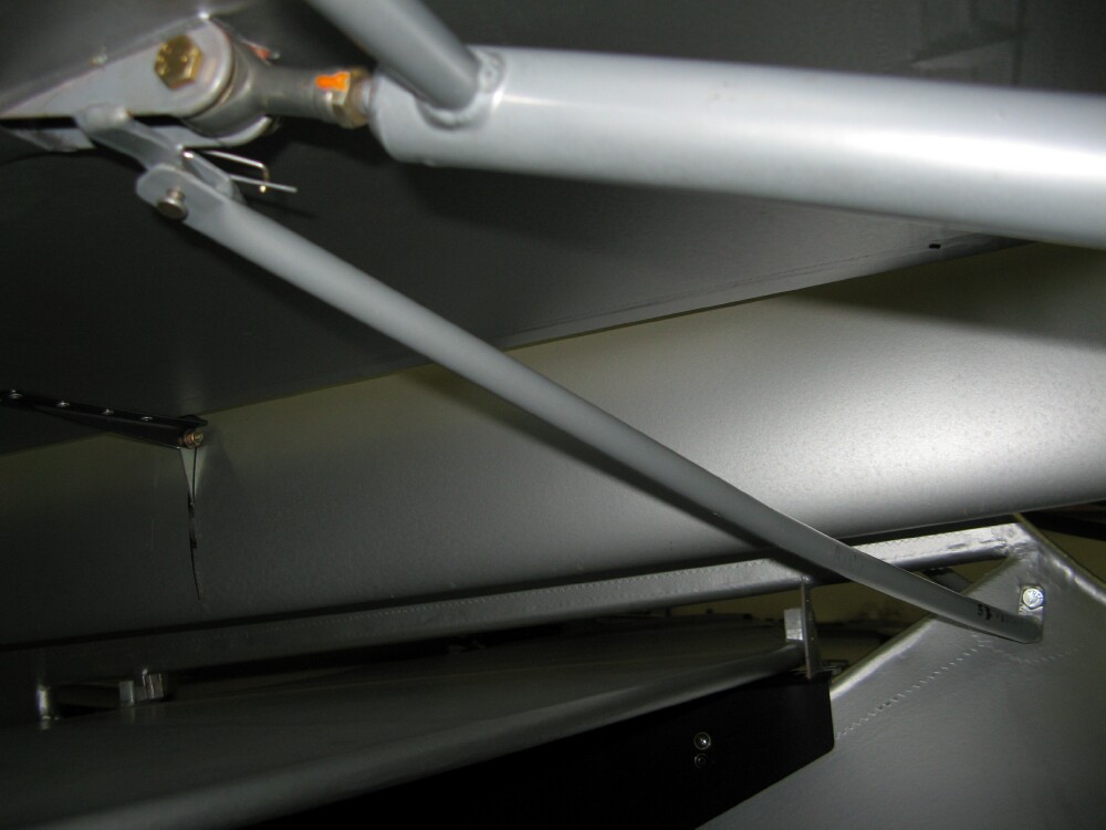

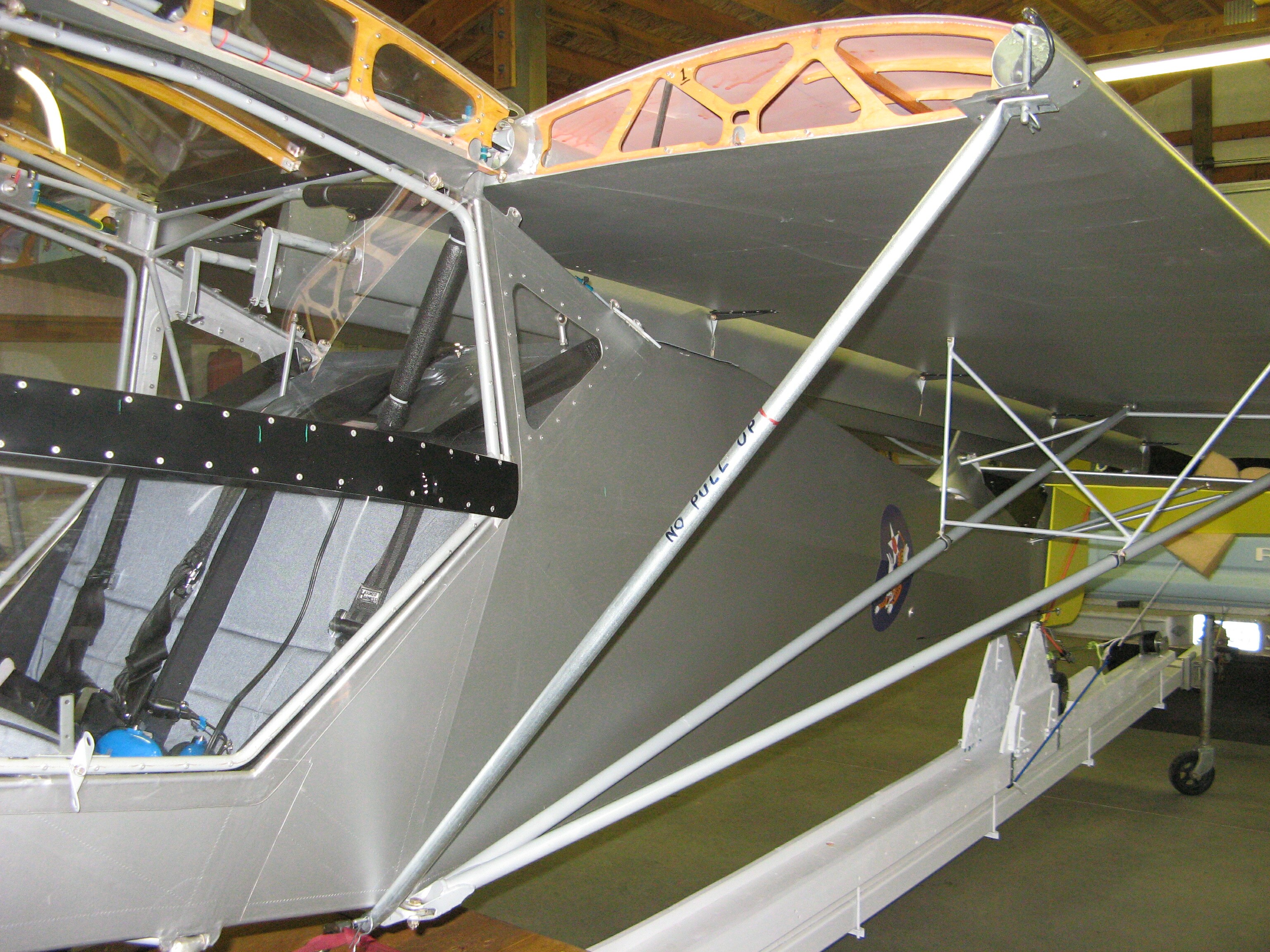

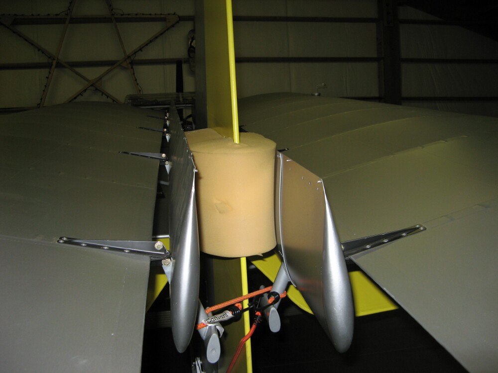

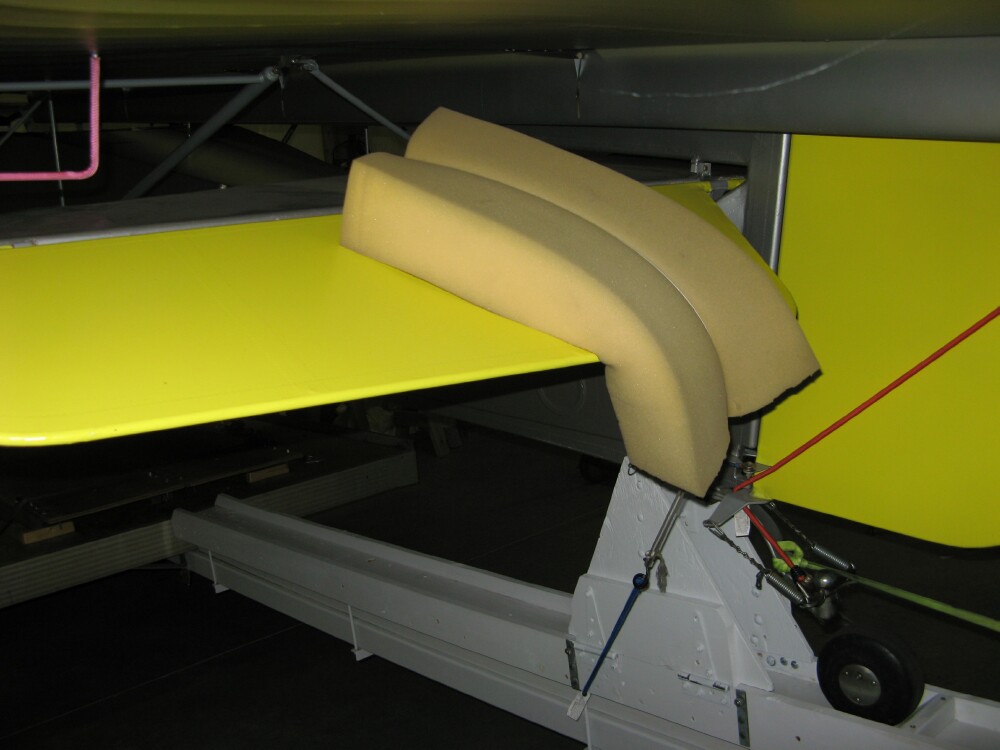

Ted,
Attached are some photos of these items on a Classic 4. The Wing Support Braces I made from 3/4" EMT. I think you can get real nice factory made ones from the kitfox factory. The wing Lock Back Braces are made from 1/2" 4130. Maybe someone has a set you could buy or borrow or check with the factory for a set...you really should have these to tow the kitfox. Also put a fail safe of some sort on to keep a wing from swinging out if a Lock back brace should fail or come off. That has ruined the day for a Kitfox owner or two. Notice in the rudder picture I use a bungee around the flaperon counter balances for this purpose. I secure the rudder and elevator with some foam rubber as shown.
 Filesize:  1.85 MB
 Viewed:  483 Time(s)
 Filesize:  90.43 KB
 Viewed:  471 Time(s)
 Filesize:  92.97 KB
 Viewed:  448 Time(s)
 Filesize:  93.28 KB
 Viewed:  475 Time(s)
