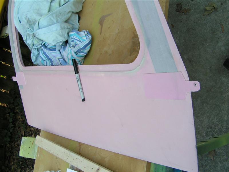

PostPosted: Thu Mar 13, 2008 6:04 pm    Post subject: Door fit Reply with quote
Robert,
Someone wrote before that "the fit is right when you are tired of sanding and re-filling and sanding" perhaps that was Deems. I made a couple of mods to the process for initial fit.
1) I glued (with super glue) two strips of trimmed door glass to the outside of the door, fore and aft where the two protruding alignment tabs are. I match drilled through the tabs into the glued on piece. THen I cut the tabs off. That allowed the door to begin its journey into flush fit with the canopy. As I took the door on and off it would go pretty much right back to where it was every time. See photo.
2) After I got the fit pretty darn good I mixed a thick epoxy/flox and spread it over the door and cabin top at the joint until I had a nice surface together. I did this just in a couple of areas that were troublesome. This mixture would not flow at all and this was with hinges on but no door seal. I then lifted the door open slightly so it wouldn't all glue together. Yes, it did pull a little ridge of the mix up but not much if done careful.
After it dried I just knocked of the ridge with the sanding block and I have a razor like fit. This is with a 45 degree style door. I also coated the 45 degree portion of the door with pure epoxy to give it durability.
I'll revisit the fit with the door seals on, those just arrived . I am trying the ones from Aviation Tech Products.
The alignment tabs supe glued on are easy to pop right off and then sand away the residue. Don't need much glue either just a couple drops.
-Chris

PostPosted: Fri Mar 14, 2008 3:22 am    Post subject: Door fit Reply with quote
John,
We put a 1/8 square rabbit in the canopy door frame. it made the door very easy to fit. Make it deep enough for the thickest part of the door. Be careful when trimming the canopy frame in way of the aluminum fuselage frame.
Please note!
After trimming the door to the factory scribe lines, take equal amounts off the forward and aft edges. The temptation is after getting one edge to fit, removing the remainder from the other edge. DON'T, because it makes the inside "jam" unequal. (Ask me how I know)
Also, the top of the canopy door frame really does not need the rabbit, The top edge of the door WILL require a bevel to open properly!
Richard Reynolds

PostPosted: Fri Mar 14, 2008 3:58 am    Post subject: Door fit Reply with quote
Richard,
I really like this idea - how did you make the rabbit? Router? How did you guide it around the frame?

PostPosted: Fri Mar 14, 2008 5:41 am    Post subject: Door fit Reply with quote
John,
Did you do the window install with the door on, or off, the fuselage?
If off, do you think that the post install fit issue could have been reduced if the install were made with the door on the fuselage?
Dave Lammers

PostPosted: Fri Mar 14, 2008 1:15 pm    Post subject: Door fit Reply with quote
Dave, I did the window install on the fuse. It was a very hot day if I recall (36C around 100F) and the weld-on went off very quickly...too quickly for my liking but my figuring on a hot day was the plexi was more pliable and less likely to suffer any cracks. I must admit, I came back a few days later and removed the doors and it wasn't until I re-installed them some weeks later that I actually noticed the problem.
It had me a little perplexed as I'd think it unlikely the bowing would have been caused by the window install and curing process. My initial thoughts were that I didn't have the doors back in their exact position when re-installed but in the end I figured a few people were suffering a similar result albeit no-one was really openly discussing it and the finer finish work was my responsibility in any case. Like I previously stated I wasted far to much time on this and it only annoyed me because all the metal work up until that point was precise and a pleasure to work on. Once I got over the "take it from the box and fit it" mentality I started to enjoy the flexibility of the glass work and the ease with which you can fix mistakes.
John 40315
