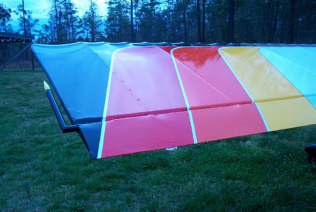

My MK III Xtra has the new Steel gear, and the center wing bolts are drilled through the top of the wing center section tabs just as they should be to minimize the angle that the large wedge of the fuselage hits the airstream. I notice the pitch changes with power, but its easy to deal with, pitch control in my MK III is light and effective.
The downward trim is not due to the engine mounting and high thrust, because it was trimmed to far down even at idle power, moving the horizontal stab and trim tabs are what it took to fix it. At first I just used trim tabs to correct the nose down tendency, but when I looked back, I could see that all the load was on the elevator and almost none on the Horizontal stab by the way the fabric was being pushed down. See the attached picture, this is my tail with only trim tabs, but the stab in stock position, two people, near max gross weight.
The Xtra did great at 90 MPH, I did not even realize it was going fast until I looked at the airspeed indicator. I have never seen any indication of the front window being pushed in, not even at 90 MPH.
Mike
Look at Fabric, all the load is being place on the elevator.
