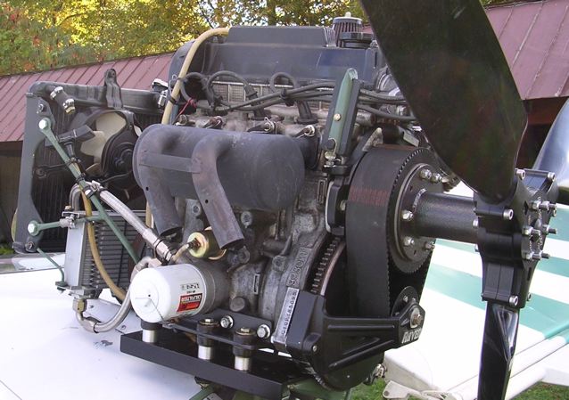

PostPosted: Sat Apr 05, 2008 10:06 am    Post subject: spark plugs Reply with quote
I also like the large, sturdy looking electrodes on the NGKs. I
tried the flimsy platinum wire Bosches
and they were ok but didn't seem to perform as well. My imagination
perhaps.
My boot type connectors stay on ok but then they are leaning into the
wind. Smile
-for the curious, the fan is for slow taxiing behind slowpokes if I
go to a flyin. I manually switch it
but a thermoswitch would be nice. Stock yamaha ventura radiator.
BB

mdnanwelch7(at)hotmail.co
PostPosted: Sat Apr 05, 2008 11:02 am    Post subject: spark plugs Reply with quote
Bob,
Regarding your radiator, what engine size was the Yamaha Vetura?? I have a snowmobile radiator on
my GEO. I can't remember the make, but IIRC, the size of the engine it cooled was about 650-700cc.
Have you ever really needed the electric fan, or is on there "just in case"?
Mike Welch

slyck(at)frontiernet.net
PostPosted: Sat Apr 05, 2008 1:22 pm    Post subject: spark plugs Reply with quote
Mike, the ventura started out as a 1200 cc and was later sold as 1300.
The key to a radiator is more air flow than size. If you locate it
near the prop you
will be better off on the ground. Mine is a mile away hence the fan.
Sitting on the ground on a hot day you will need some kind of
enhancement.
A couple years ago I popped a coolant hose inflight and my oil cooler
saved the day.
I reported at the time that I heard a scraping sound when I hand
turned the prop
before the completion of my journey. -That turned out to be the ONLY
bolt that wasn't
safety wired, a water pump bolt that worked its way out to scrape on
the back of the
pulley. In my defense, it was not a very noticeable or accessible
location.
I can actually watch my temp gauge go back down when I flick the switch.
BB

I'm going to run out to the shop and measure my radiator size. Back in sec......
Okay, here's what I've got: 7.5 inches wide X 8.5 inches tall X 1.5 inches deep. These dimensions are of the actual finned area.
My radiator location looks to be about the same as your's...front of the engine. I also have an oil cooler I plan on installing, probably near the prop somewhere.
Do you think my radiator is big enough?? I appreciate your opinion. Although I have had my engine/prop running long ago, I haven't flown it yet.
Mike W.
From: slyck(at)frontiernet.net
Subject: Re: spark plugs
Date: Sat, 5 Apr 2008 17:19:52 -0400
--> Kolb-List message posted by: robert bean <slyck(at)frontiernet.net>
near the prop you
enhancement.
saved the day.
turned the prop
bolt that wasn't
the back of the
location.
BB
