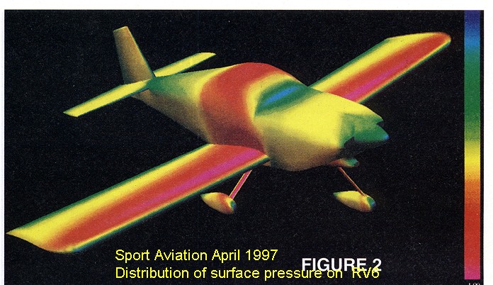

I am in the process of working the intake and exhaust heat flow and am
wondering if anyone has done a field flow on the RV-10. It makes sense for
air to exhaust into a low pressure area and enter in a high pressure area.
Hense the need for the air field flow, if that is what it is called.
Thanks in advance
Bob K

Bob,
RV6 pressure plot attached. The pressure areas on our 10's should be
very similar if your using the stock cowl. The pressure does change
depending on angle of attack. Here is another good site with lots of
pressure data. Different airframe but the basic principles apply.
http://www.melmoth2.com/
Bobby Hughes
40116
