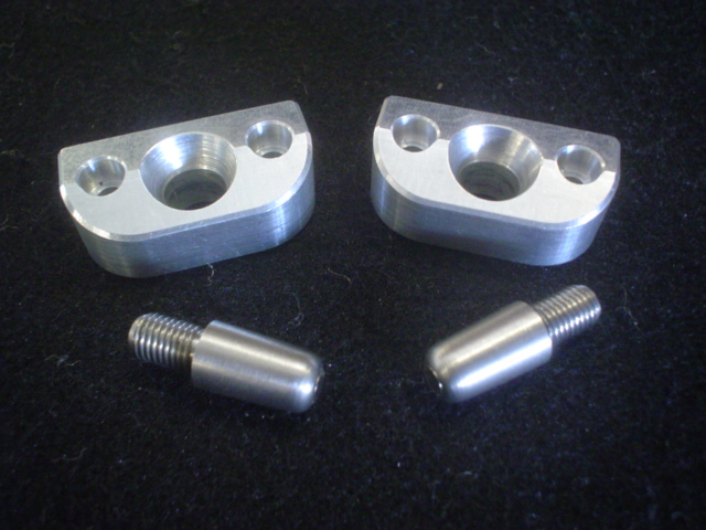

better off with the rivethead door latch pins. I don't
have them, but I see that there are some good benefits
to having them. Anything you can do to make it better
is good.
is good.

When I went to install a set in my rv10, I modified them to be much easier
to install. After seeing my mods coupled with the shipping delays I was
asked to reproduce a similar product by a few builders. I think they are a
very good anchor for the door rods to latch into, and should add a margin of
strength to the latch mech. I do offer them on my website (available
immediately Wink sorry for the commercial announcement, I just want all to
know there are options...
Steve dinieri

PostPosted: Wed Apr 09, 2008 7:58 am    Post subject: The King has no Clothes Reply with quote
John,
99 gets you parts for both doors, aluminum sockets, stainless pins
with magnets, 10-32 stainless allen-screws and platenuts. Includes priority
shipping (3 day) usps.
Thanks steve

I have ordered the Rivethead door pins and I'm looking forward to installing them.
Is anyone concerned about cutting the door rod and having a weak point where it threads in?
Does anyone have any concerns about the system being less robust than the standard rods?
Scott Schmidt

That was my concern as well. I really would like to do it but
it would be nice to get the pins in hand so you can see exactly
where the threaded connection is. I'd really prefer to have 4 or
6 inches of pin before the threaded area, because I don't want
to tap my pins, and then have that junction crack, the pin to
fall out of the main rod, and then have the door come off.
With enough pin both inside the door and inside the frame though
that is one solid piece, I'd have no worry.

My general comment would be no, I do not have any concerns. The end of the rod was already threaded per plans and all I did was fill them. ( Not exactly since I cut and threaded the rods again to shorten them.) But, they are not real tight. After 25 flight hours and the web traffic from last week, I inspected them and did not see any signs of wear. I rechecked their alignment and put some locktite on the threads. I installed mine per the video and thus they do not extend all the way into the cabin frame, only into the block itself. I am re-thinking that………..
Also, when you install the blocks there is very little room between the AL blocks and the nylon blocks in the door. I had to cut down the blocks on the door just to get the door to close. I think this closer tolerance helps to reduce the stress on the rod itself.

PostPosted: Wed Apr 09, 2008 2:40 pm    Post subject: The King has no Clothes Reply with quote
I am concerned about it. Not sure how to fix it though.
