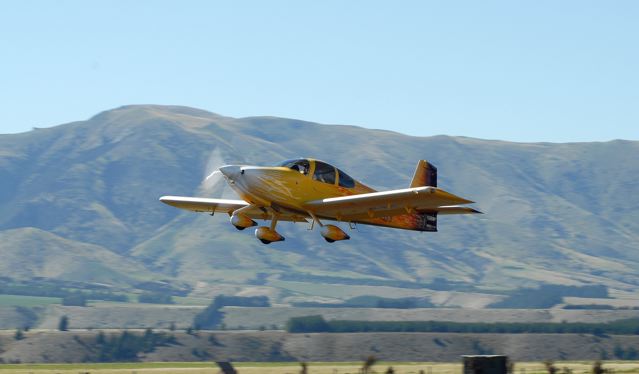

 ps- Take off with Sarah PIC at Warbirds over Wanaka a couple of weeks
 back. Osh may be bigger, but Wanaka surely has the best setting
 anywhere for an airshow.

 The Warbirds acts as breathtaking as the setting at Wanaka.  See you for
 OSH '08.
  back. Osh may be bigger, but Wanaka surely has the best setting anywhere
  for an airshow.
