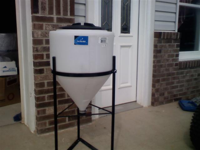

Ethanol can it be removed from fuel by adding water to this 15 gal tank (see Photo) If so what is the ratio of water to fuel? I plan on adding water and shaking it up. Then letting it sit and drain off the water and Ethanol off the bottom. Based on the fact that there is 10% Ethanol in the fuel how far below 93 does it lower the rating? Is there any thing that I am missing by doing this. I have 1995 model IV fiberglass wing tanks and do not want a engine out from the resin break down.
The waste could be used for cleaning parts and such.

That's a good question...Wish I had the answer for sure. The RON for
ethanol is reported as being 116. I think gas without ethanol is 87. If
you can find it toluene has a rating of 114 so for special purposes it can
boost the RON again. If you are flying a 582 that should be Ok. A 914 will
require an octane booster... preferably not lead.
There are guys I've come across, one in New York who have been doing this
for their boat engines for years. The main thing to look out for is pinging
aka detonation.
How much water to use? Test to be sure. For 15 gallons of gas there is
only 1.5 gallons of ethanol to remove. If ethanol will in excess of 80% its
volume in water I would start with a trial of one quart of water. Then test
the gas with a jar or test tube. If it proves to be cleaned great if it
still seems to show ethanol in the fuel add another cup of water.
When mixing use an air operated agitator and be sure to let it stand for a
minimum of twenty minutes to allow the smallest "bubbles" of water to settle
to the bottom of the tank.
Also, you can siphon the gas off the top or on that fancy barrel just drain
the water off first.
Best of luck
Noel

Lee,
I just want to raise a safety issue here. In addition to lowering the
octane rating, you are adding water to the gas. You need to add a step to
dry the gas after your process. Mole sieves or such. Otherwise when you
fly into colder weather, you risk separation of the water and gas line
freeze or ingestion of water into the engine. - either could make things
real quiet up there. Even if it works real well, there are going to be some
mistakes made, which can cause problems.
You could buy some alcohol (methanol or ethanol or isopropanol) to add to
the gas to keep the water in solution.
Randy

Water won't mix, or form solutions with gasoline... Sorry the same is not
true with ethanol. To remove water from gas just let it sit... all the
water will settle to the bottom of the container.
Water dissolved in ethanol which is mixed with gas is one of the problems we
are trying to get around.
Noel

Get your self a chemistry book. Water dissolves in gasoline up to a certain
percentage. Beyond that it separates into two phases. The small amount of
water that is dissolved in the gasoline will come out of solution if the
gasoline is cooled. If you are in the air while you are cooling your home
made fuel, you may get an unpleasant surprise.
Similarly, gas dissolves in water. - But to a lesser degree. This is why
a small amount of gasoline can contaminate a very large amount of water.
Gasoline changes all the time. Some has more benzene than other gas. Some
has more toluene or xylenes than others. The amount of water that is
soluble in the gas changes with the amount of these and other components of
gasoline.
Look for some ternary phase diagrams of water, ethanol and octane. You will
figure it out.

Thanks I have lots of Chemistry books. Yes there is a minimal dissolving of water in gasoline (PPB). For all practical purposes, none. Certainly not enough to separate from the gasoline by temperature changes or be the principal cause of carb icing. If that were true ethanol would be a required ingredient of 100LL. Funny it’s not. Funny the accepted method of removing water form 100LL is to drain water drops from the sumps until no droplets can be found or filter the gas through a chamois or felt.
The same is not true for gasoline that has been contaminated with ethanol. Once contaminated with ethanol the gas can separate from the gas. This phase separation occurs much easier if there is oil present in the gasoline.
I did however do a quick search for solubility of water into gasoline. There were several notations of this but they almost all related to the water actually forming a solution with ethanol in the gas. There is a reference to the addition of salt HCL in the water making it more soluble for gasoline if the concentrations of HCL are correct.
I searched further and found this.
“Gasoline and water do not mix because the non-polar hydrocarbon molecules (water is polar) would disrupt the water in such a way as to produce a structure that was actually lower entropy; therefore, the mixture is less likely to exist than the separate liquids.” Sounds good but I can’t confirm the reliability of the source.
The idea that gasoline is more conducive to carb icing or water separation over ethanol contaminated gas is lacking in substance. Just check your chemistry books.
Noel
