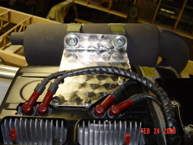

Posted: Thu Apr 17, 2008 1:57 pm Post subject: Re: 582 muff Brackets |
Here's a style I made for mine.... Made outa Stainless Steel
It's flown about 3 seasons now.... Just made one fer somebody else too.

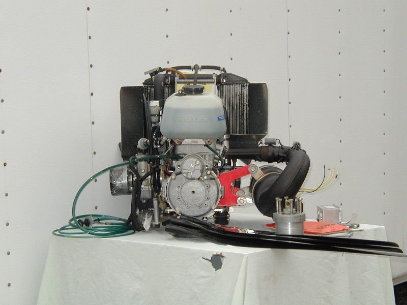

Posted: Thu Apr 17, 2008 5:32 pm Post subject: 582 muff Brackets |
Jim,
This was the muffler mount that came from Kolb for the 582 muffler. The rubber bushings between the red brackets and the muffler bracket were good for about 100 to 150 hours.
